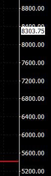

I upgraded to v2017 (29263m). The price scale range on the charts is set to Automatic/Linear. When i upgraded, the scale became very compressed. The only way to get the price bars to appear is by changing the scale to Independent or Constant Range. This occurs in both 32b & 64b versions. What do i need to do to have the bars appear under Automatic scaling again ?

Go to that chart and select Chart >> Reset Scales.
We do not see how an update would change the scale.
Refer to:
Chart Scale and Scale Adjusting: Chart Bars or Studies Not Completely within View, Not Displayed, or Cut Off. Reset Scales.

I just tried that and no change. I have attached a screen cap of what it looks like. Note the 400 point range between lines on the NQ. Could the update have changed an indicator setting ?

Because i am a nice person, i will tell you the issue and fix. When i upgraded several SC versions, all of the 'color bar based..' studies added a 'sum of alerts' line directly to the charts. These subgraphs drew 'zero lines' and changed the scale format on the chart itself. I went to the subgraphs tab in the studies setting and changed the draw style to ignore. Problem solved.
