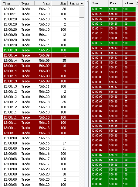

Hello, after several tests I found that TuS in SC does not show all the data that
is available from the data feed. E.G. share sizes < 100 seem to be ignored and do not
show up in the TuS stream. Trades filled between Ask and Bid appear as if they are filled
at ask or bid. For me it is important to have unfiltered data available in TuS. Is it possible to implement TuS is such a way that the trader can decide what he wants to see and
what not ?

User39772 - Posts: 311
I use:
a) IQFeed + SC (prints < 100 share are not visible in TuS)
b) IQFeed + other Tool (prints < 100 shares are visible in TuS + all shown by SC TuS )
Since I have no filters set, I assume this is an internal issue of SC.
The other issue regarding the prints filled between Bid and Ask has nothing to do with
the data feed, since the charting tools handle this. In the second tool I use it is
possible to color code every possible state a print might have.
Happy christmas and a profitable new year !

[2013-12-24 17:07:08]
Pls. see attached files. They show TuS of SC and the other tools and the TuS settings of SC filters. As you can see no filters set. Yes I use two instances of SC. One connected to IQFeed directly. The problem appears in both instances, i.e. in the SC instance connected to IQFeed and in the second instance.
It is the case with every symbol, e.g. AAPL (see file) but also with other symbols.
imageTUS.gif / V - Attached On 2013-12-24 17:02:14 UTC - Size: 25.89 KB - 716 views
imageFilter.gif / V - Attached On 2013-12-24 17:04:10 UTC - Size: 5.96 KB - 689 views
[2013-12-24 17:25:27]
This is interesting. We had a look at the raw IQ Feed data feed and these other apparent trades are identified with an "o" identifier.
This is not indicated to be a trade. So this is misidentification and/or mis-documentation by IQ Feed. They are the ones responsible for this issue. We will ask them about this, but we will go ahead and start including these updates as trades.
