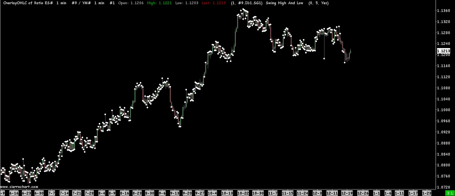

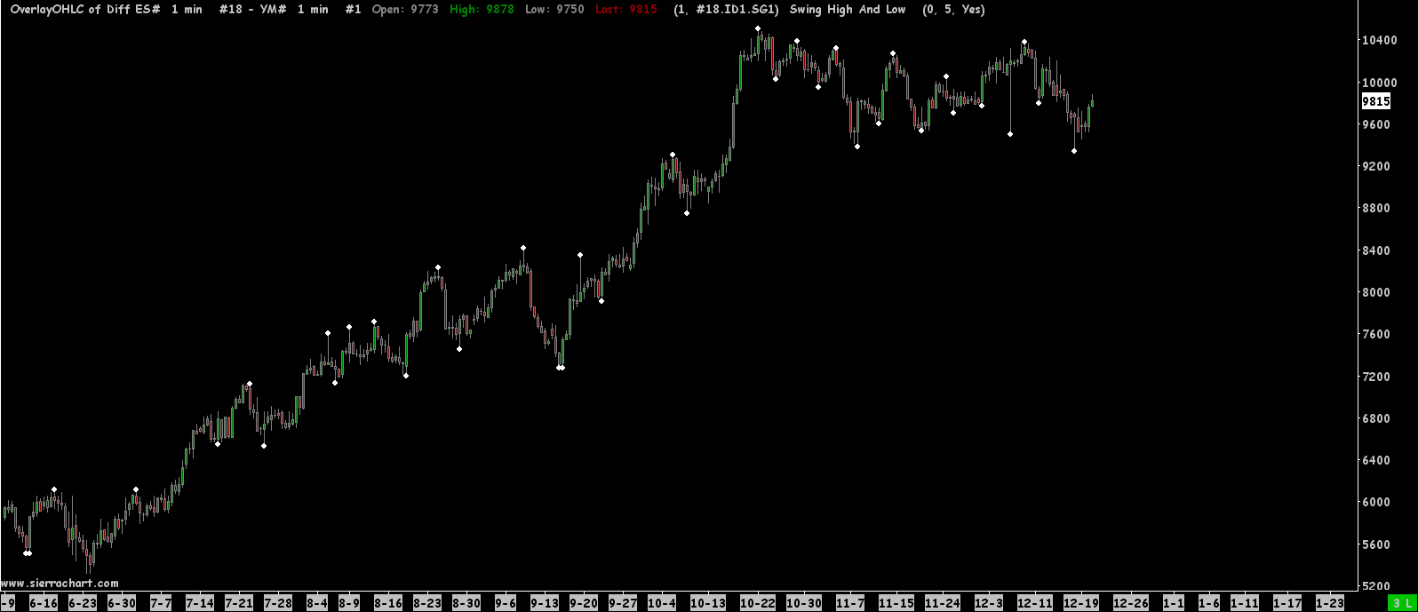

I'm having an issue with using the Swing Hi/Lo study on spread ratio charts. The problem does not exist on spread diff charts. Study uses Hi/Lo strength of 5. Running current version 1062.
Link to Spread/Diff chart image:
http://www.sierrachart.com/image.php?l=1387827467194.png
Link to Spread/Ratio chart image:

We know what the problem is. Set the Price Display Format in Chart >> Chart Settings to .0001.
[2013-12-24 05:31:33]
bekitz - Posts: 26
That did the trick!! Thank you much. I appreciate the help given your backlog of chores.
