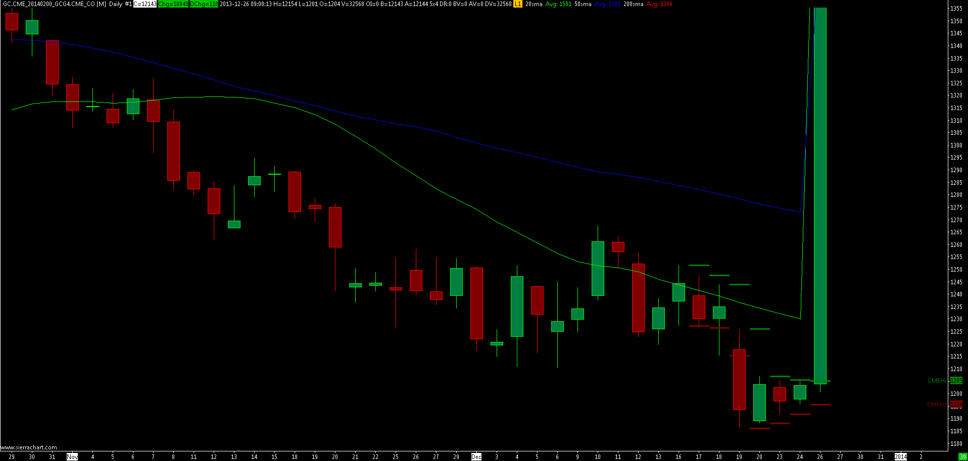

It is still happening today. v1064 after a full symbol reset, new chartbook, new 1m chart with no studies. SIM, CTS, SC RTDF
http://www.sierrachart.com/image.php?l=1388069742662.png
All of the daily charts are doing this.
Using GC as an example: Studies: Daily OHLC and 3MAs. Also deleted all ..\data\gc* files and tried a new blank chartbook with same results.
http://www.sierrachart.com/image.php?l=1388070502709.png

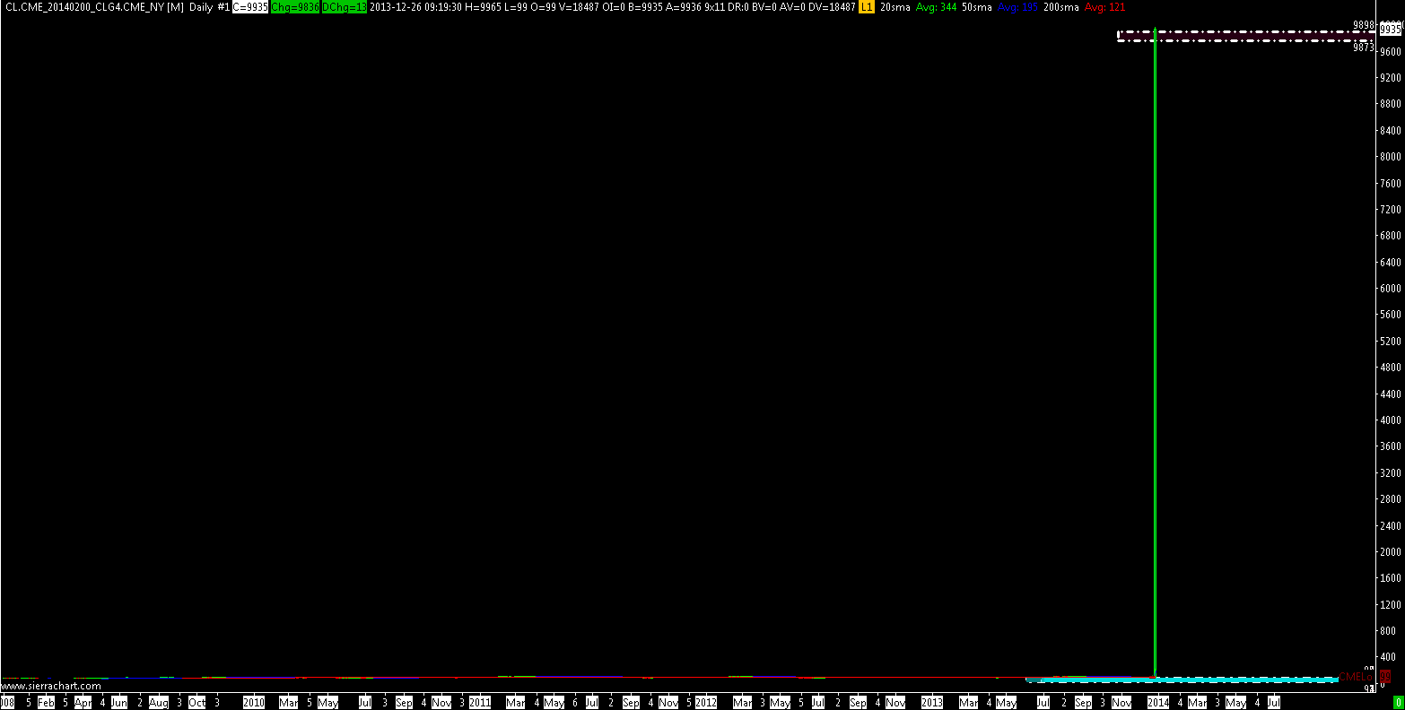

CL
http://www.sierrachart.com/image.php?l=1388071177149.png

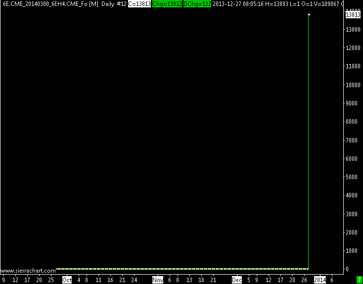

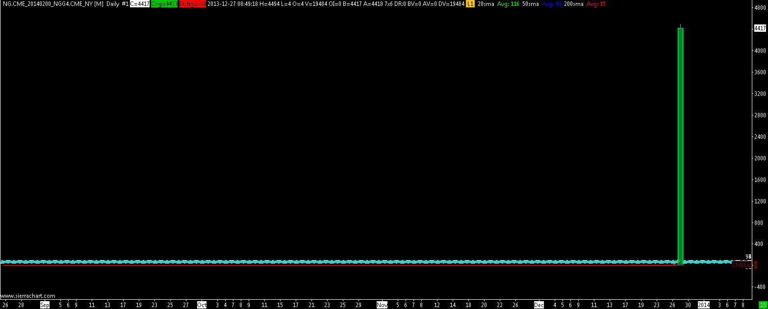

6E and NG still need some help.
http://www.sierrachart.com/image.php?l=1388153118125.png
http://www.sierrachart.com/image.php?l=1388155761868.png

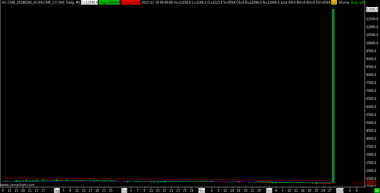

I use 1 chartbook with multiple charts and 1 QuoteBoard to quickly switch between symbols. It does not seem to matter if I choose the symbols from the QuoteBoard or Find them manually.
These are the remaining symbols that do not open and have a mismatched historical chart, looks like something to do with decimal places and cts not using them. It is causing trouble because I use the Daily OHLC on the historical chart and overlay it on all the intraday charts.
6B
ES
GC http://www.sierrachart.com/image.php?l=1388373576405.png

Yes. Lets work on GC.
The daily chart values area window shows incorrect data and the last candle is tooo high.
2013/12/27, O,H,L,Last 1210.0, 1218.9, 1208.5, 1214.0
2013/12/30, O,H,L,Last 1213.8, 12158.0, 1200.2, 12037.0
If I edit the historical data, the last day shows correct data.
2013/12/20, 1189, 1206.9, 1188, 1203.7, 138710, 234037
2013/12/23, 1202.5, 1205.6, 1191.8, 1197, 84975, 230994
2013/12/24, 1197.8, 1205.1, 1195.5, 1203.3, 43489, 228429
2013/12/26, 1203.8, 1215.4, 1200.5, 1212.3, 54652, 223741
2013/12/27, 1210.9, 1218.9, 1208.5, 1214, 83755, 222800
2013/12/30, 1213.8, 1215.8, 1200.2, 1203.8, 36316, 0
GC.CME_20140200_GCG4.CME_CO is the symbol in the QuoteBoard.
It shows last:12037.0, high:12158.0, low:12002.0
I've pressed Reset, Apply, Update, Apply, Delete and Download, deleted all GC* files, updated to the latest pre-release. Not sure what else I can do.
