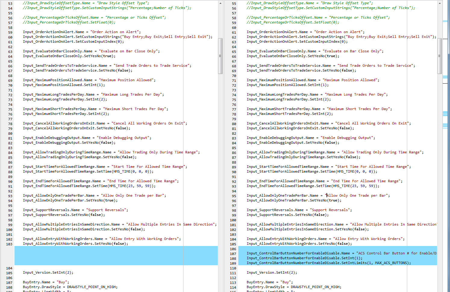

[2019-12-12 11:06:37]
Ackin - Posts: 1866
Both versions differ only by the "ACS Control Bar Button"
imagediff1.png / V - Attached On 2019-12-12 11:06:15 UTC - Size: 118.25 KB - 474 views
imagediff2.png / V - Attached On 2019-12-12 11:06:25 UTC - Size: 90.81 KB - 467 views
