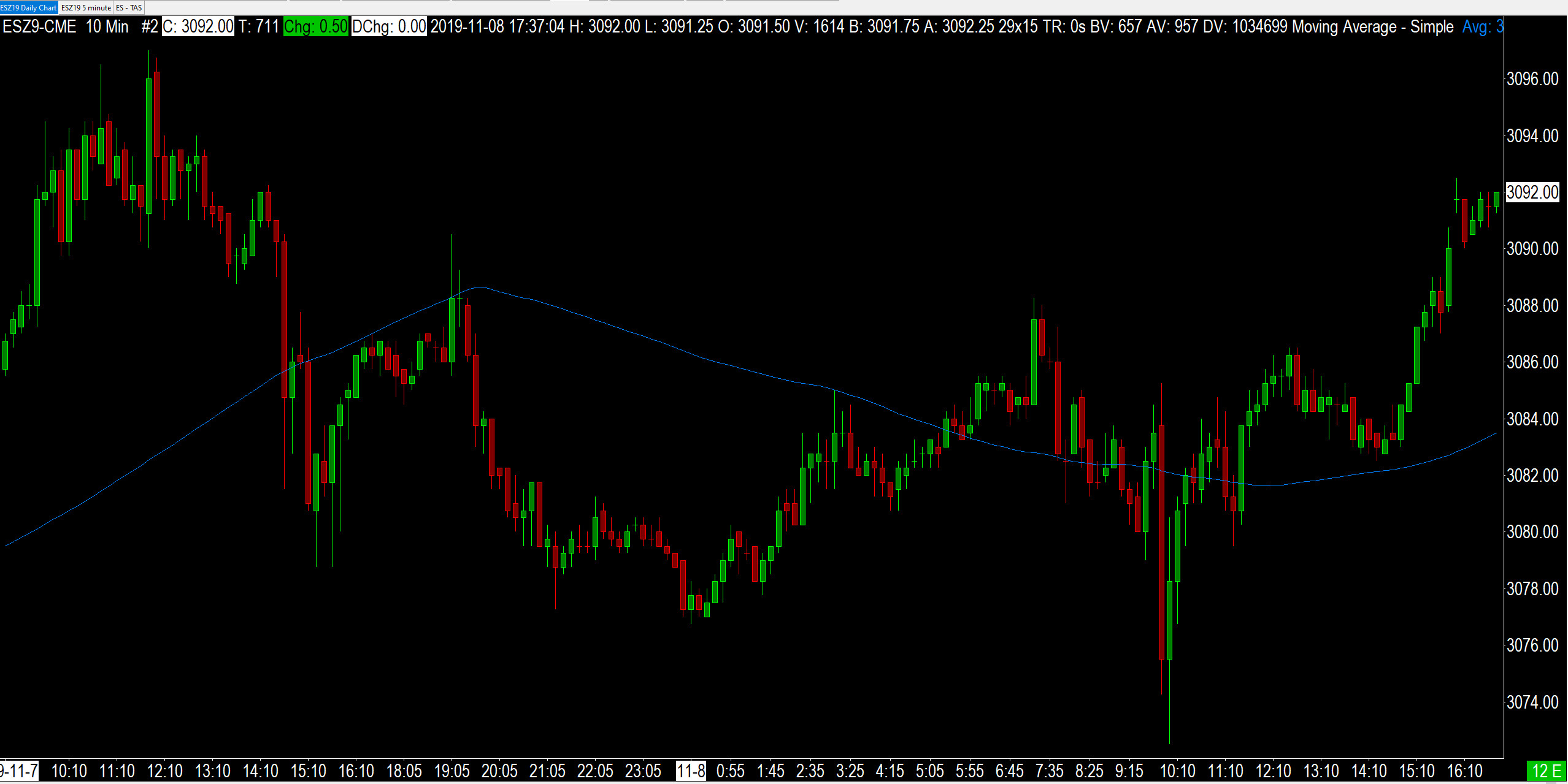

Hi how do you make all candles green above specified moving average & red below the moving average
Ive read this post below but I still cant figure out the steps - initial to complete -of how to make all the changes to go from how my chart is now (attached) to get one like you posted in the link below
Color Bar Based On Above/Below Study
imagepaint bars - green above moving average and red below moving.jpg / V - Attached On 2019-11-09 19:05:43 UTC - Size: 255.14 KB - 555 views
imagehow the chart is now before paintbar for moving average.jpg / V - Attached On 2019-11-09 19:11:19 UTC - Size: 431.28 KB - 478 views

Provide us that chart:
[2019-11-10 07:48:42]
Jay Greenlees - Posts: 15
The requested chart is attached - thanks
attachmentESZ19 FIVE MIN.cht - Attached On 2019-11-10 07:46:21 UTC - Size: 130.06 KB - 435 views
[2019-11-11 16:23:06]
John - SC Support - Posts: 48095
Here is the Chartbook with the study Color Bar Based On Above/Below Study added to chart #3. This gives Green when the Last price of the bar is above the Simple Moving Average, and Red when the Last price is below the Simple Moving Average.
attachmentESZ19 FIVE MIN.cht - Attached On 2019-11-11 16:22:57 UTC - Size: 139.49 KB - 577 views
