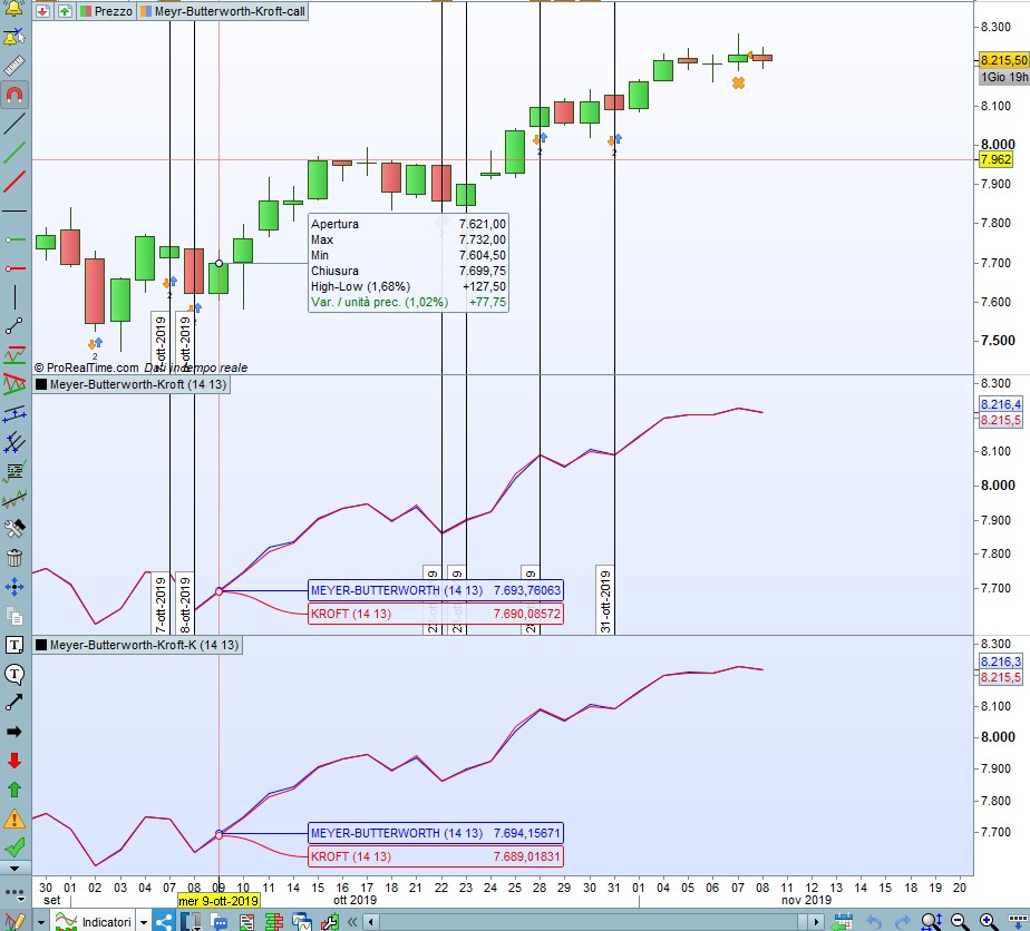

GiovanniD - Posts: 41
Why double?
I attach 2 images where you can see an indicator that I have programmed in PRT time ago and that I can't to carry on Sierra because I believe the float type is not enough for that indicator.. I made several attempts as you can see in the image.. but I am not satisfied ..
imageSC support 1.jpg / V - Attached On 2019-11-08 10:14:49 UTC - Size: 140.83 KB - 486 views
imageSC support 2.jpg / V - Attached On 2019-11-08 10:14:55 UTC - Size: 192.29 KB - 530 views

[2019-11-11 10:41:05]
ok, the explanations are clear, but unfortunately they do not solve the problem.
In my indicator I need of several calculation of the standard deviation in double format.
The compiler has indicated to me that the internal calculation function asks for a float vector at the output:
StdDeviation (SCFloatArrayRef In, SCFloatArrayRef Out, int Index, int Length)
So I think that the only possibility that I have is to create a function for the calculation of the standard deviation that returns double values, I imagine that there is not an internal function that returns these values, right?
