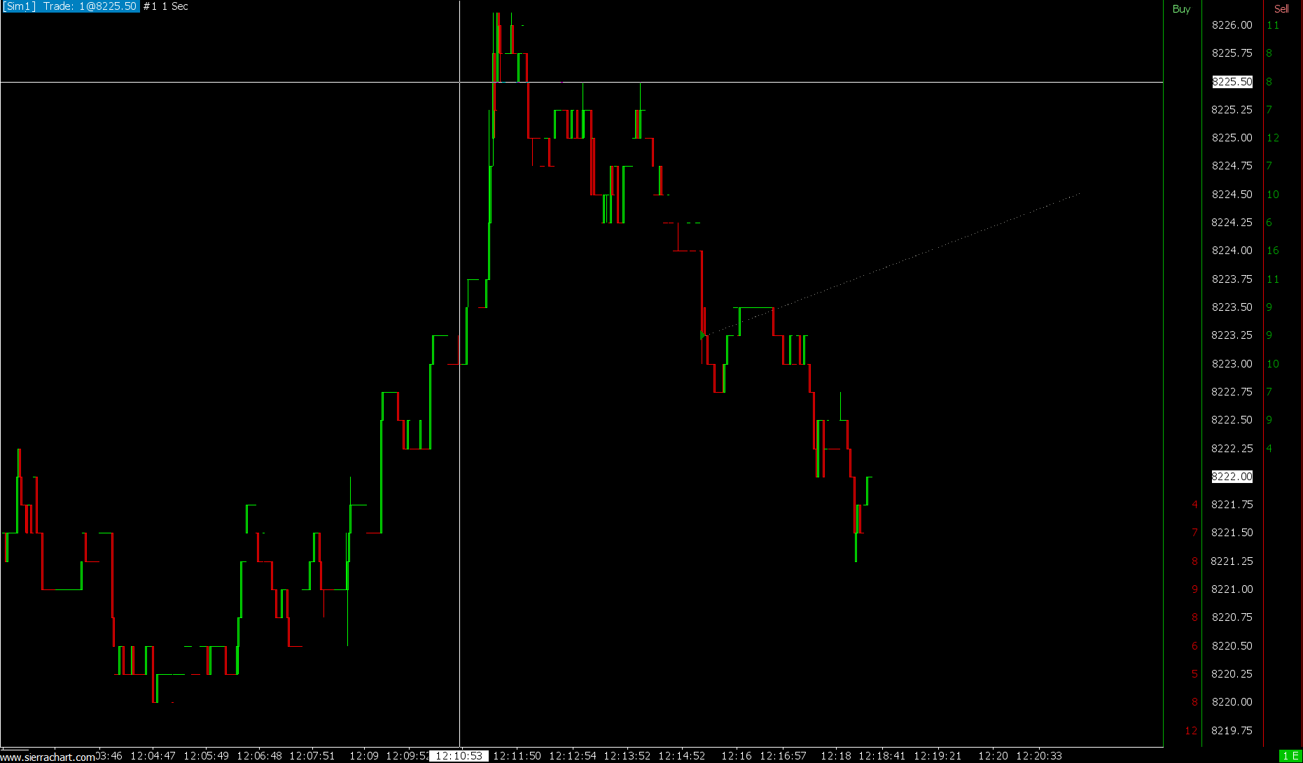

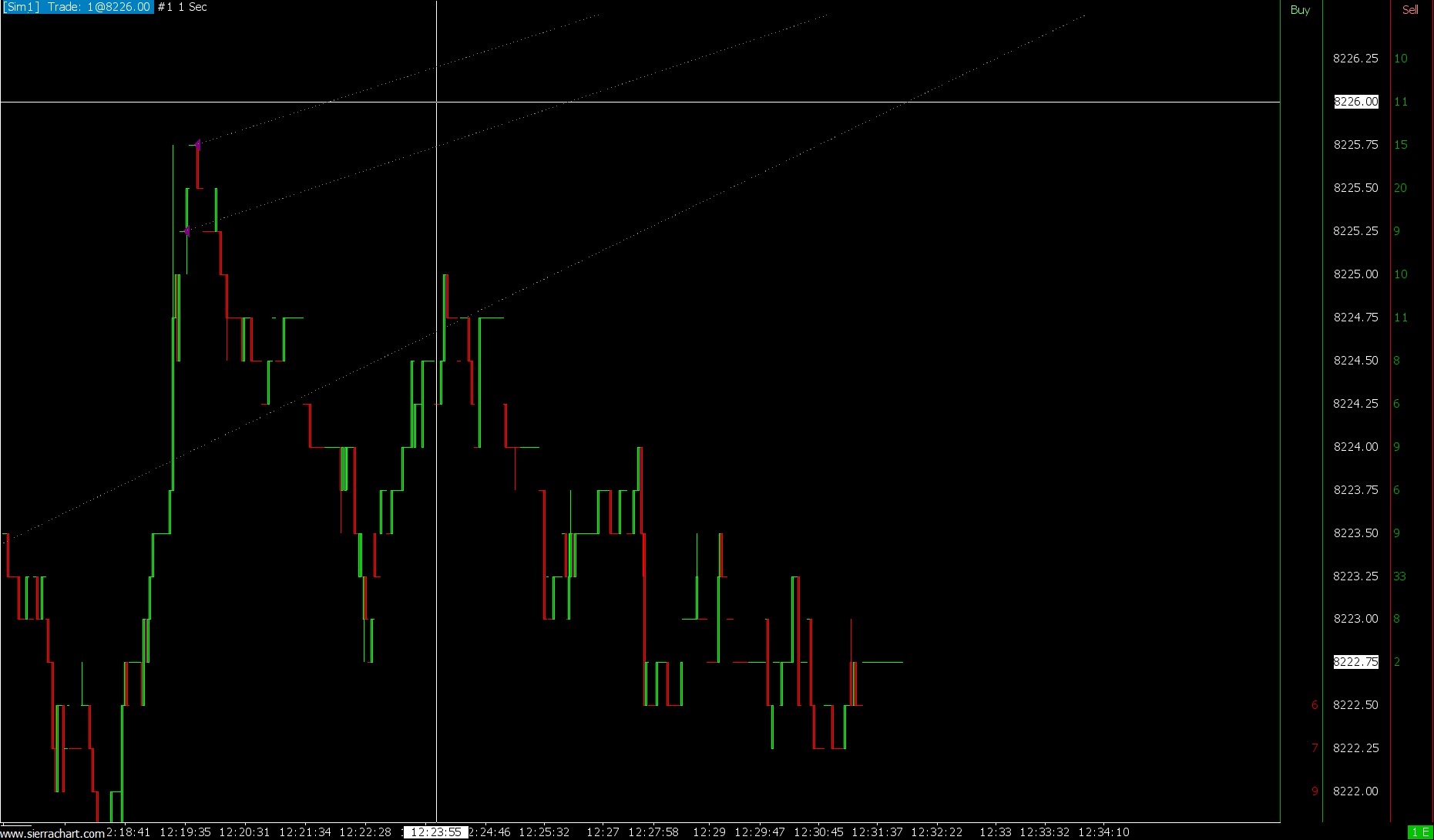

[2019-11-08 12:36:41]
caligola - Posts: 116
a couple of screenshots and the chartbook are attached
look at the Order Fills, how is possible that my trades are filled in the future?
http://www.sierrachart.com/image.php?Image=1573216090763.png
http://www.sierrachart.com/image.php?Image=1573216193576.png
attachmentReplay issue.Cht - Attached On 2019-11-08 12:36:16 UTC - Size: 22.72 KB - 642 views
