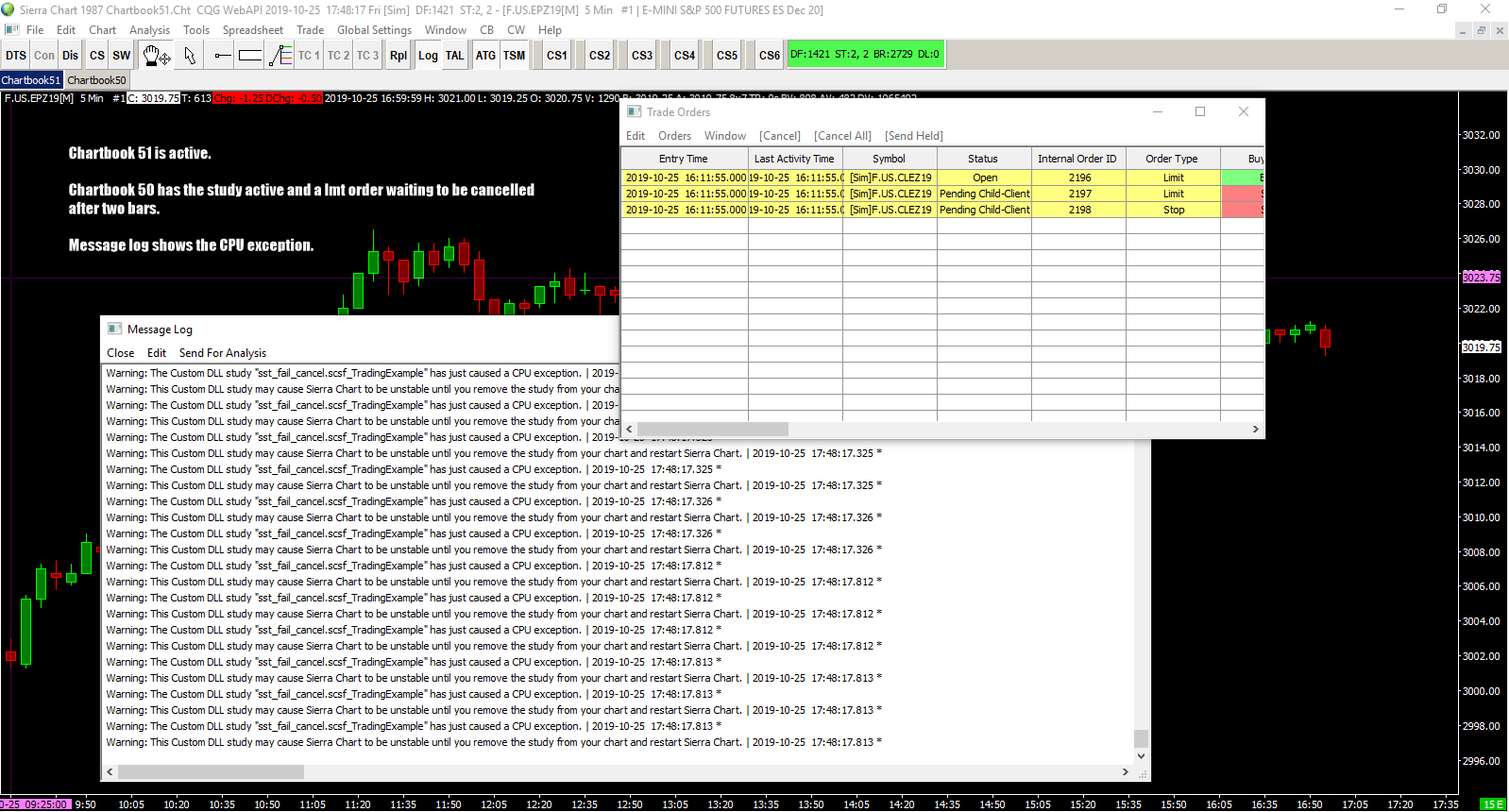

@sstfrederik - Posts: 413
I know it does not make sense but I see it happen. Nobody likes exceptions. But this needs to be solved.
This issue is only present when the chartbook the study is loaded on that has a CancelOrder function call is not an active window.
I will include some pics and two chartbooks and dll so you can reproduce this.

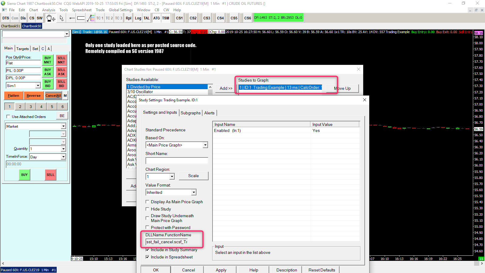

[2019-10-25 21:58:41]
Here are the pics.
This happens in replay as well as in live conditions.
PS the order Id are different because I had to run this again for screenshot purposes.

We saw the 3 orders originating from Chartbook 50 get submitted, and later canceled after about two minutes while looking at Chartbook number 51 and no exceptions. This is using your global configuration file (Sierra3.CFG).
We recommend that you restart Sierra Chart and do not use any custom study other than this one custom study that is very simple and test again.
