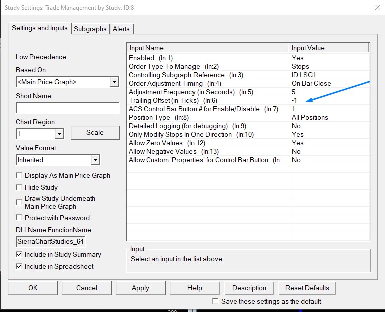

Can you please confirm if this is the correct setting in using the Trailing Offset input parameter? My controlling study subgraph (ID1.SG1 - this is the 10 Exponential Moving Average). If I want to enable a trailing stop one tick below ID1.SG1, can I use "-1" in the Trailing Offset field? See attached screenshot.
However, how would I configure it so that the trailing stop is triggered if the price is 1 tick above ID1.SG1 for a short position and -1 tick below (-1) below ID1.SG1 if it is a long position?

This is very well explained with the Input description here:
Attached Orders: Trade Management by Study Input Settings

User94606 - Posts: 327
Does this mean I need to create two Trade Management by Study - one for long and another one for short position? or can I use only one study for both (short and long)?
[2019-10-14 14:06:01]
You should not have any problem using the same study instance. It can handle both short and long Positions.
