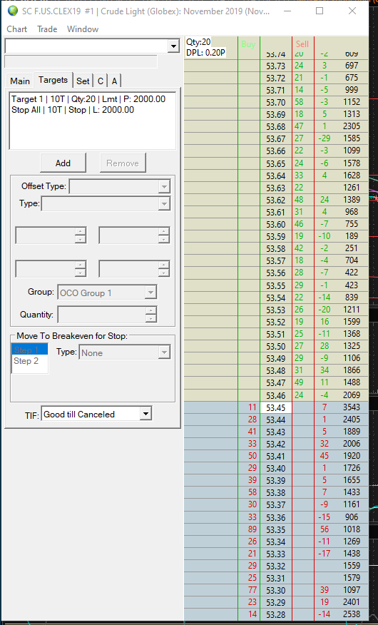

I had a simple bracket order 10 ticks away to close and 10 ticks to stop out and it did not trigger properly. I know it reached my closed order and only closed out 5 positions but worst it reached my stop and only closed out 3 positions now I have 12 positions going against me wtf.
It's a simple bracket order there shouldn't be anything to this.

File attached
imageactivity.png / V - Attached On 2019-10-01 17:07:47 UTC - Size: 99.53 KB - 498 views
imagedom.png / V - Attached On 2019-10-01 17:07:50 UTC - Size: 71.55 KB - 519 views
imageservice.png / V - Attached On 2019-10-01 17:07:53 UTC - Size: 206.1 KB - 486 views

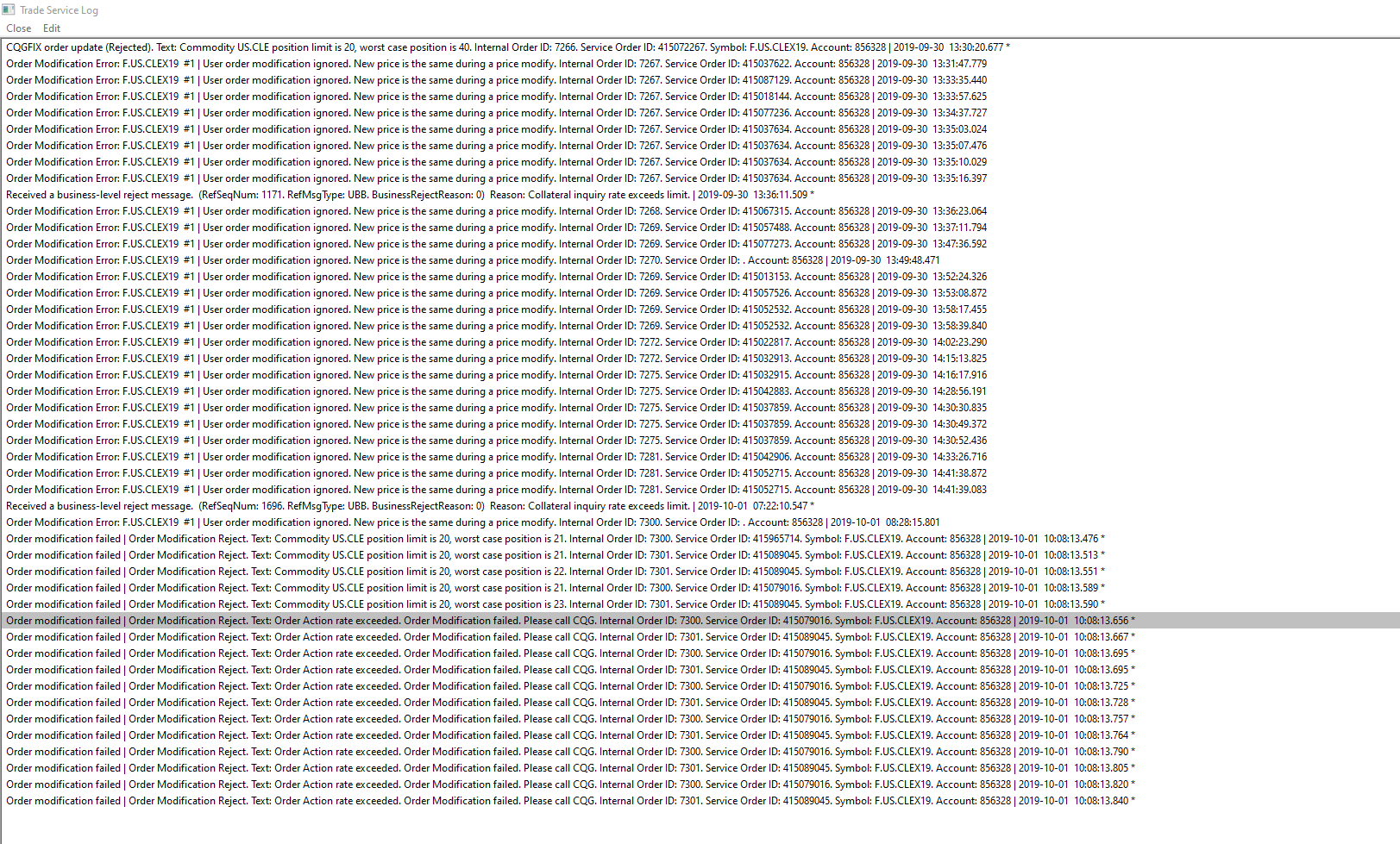

There is a procedure for this and that is documented here:
Trade Activity Log Analysis: Support Assisted Trade Activity Log Analysis
However, based on the last screenshot you provided, the problem you had is as documented here:
Attached Orders: Failure to Increase Quantity Due Order Modification Rejection from Margin/Position Limits
So we do not need any further information. You are able to resolve this with your broker and their risk management.
