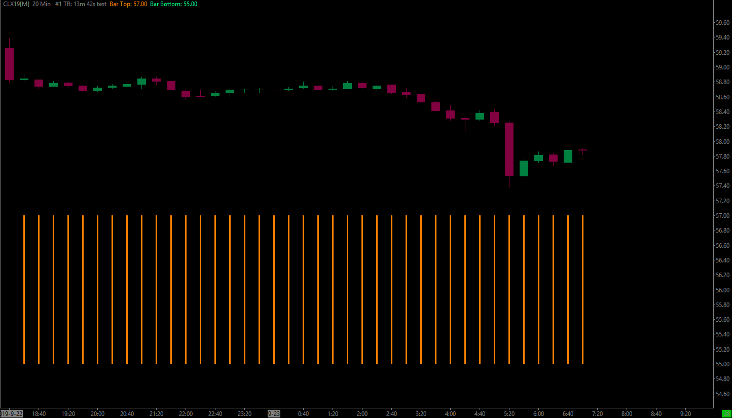

[2019-09-23 11:12:02]
User353585 - Posts: 69
This is the image of example, with the following test study applied.
SCSubgraphRef Subgraph_1 = sc.Subgraph[0];
SCSubgraphRef Subgraph_2 = sc.Subgraph[1];
if (sc.SetDefaults)
sc.GraphName = "test";
sc.GraphRegion = 0;
sc.UpdateAlways = 0;
sc.AutoLoop = 1;
sc.DataStartIndex = 0;
sc.Subgraph[0].Name = "Bar Top";
sc.Subgraph[0].DrawStyle = DRAWSTYLE_BAR_TOP;
sc.Subgraph[0].LineWidth = 3;
sc.Subgraph[0].PrimaryColor = RGB(255, 128, 0);
sc.Subgraph[0].DrawZeros = false;
sc.Subgraph[1].Name = "Bar Bottom";
sc.Subgraph[1].DrawStyle = DRAWSTYLE_BAR_BOTTOM;
sc.Subgraph[1].LineWidth = 3;
sc.Subgraph[1].PrimaryColor = RGB(0, 255, 128);
sc.Subgraph[1].DrawZeros = false;
return;
sc.Subgraph[0][sc.Index] = 57;
sc.Subgraph[1][sc.Index] = 55;
imageCLX19[M] 20 Min #1 2019-09-23 07_06_20.746.png / V - Attached On 2019-09-23 11:11:52 UTC - Size: 19.98 KB - 390 views
[2019-09-26 09:37:37]
We understand why this occurs and we will implement a solution.
