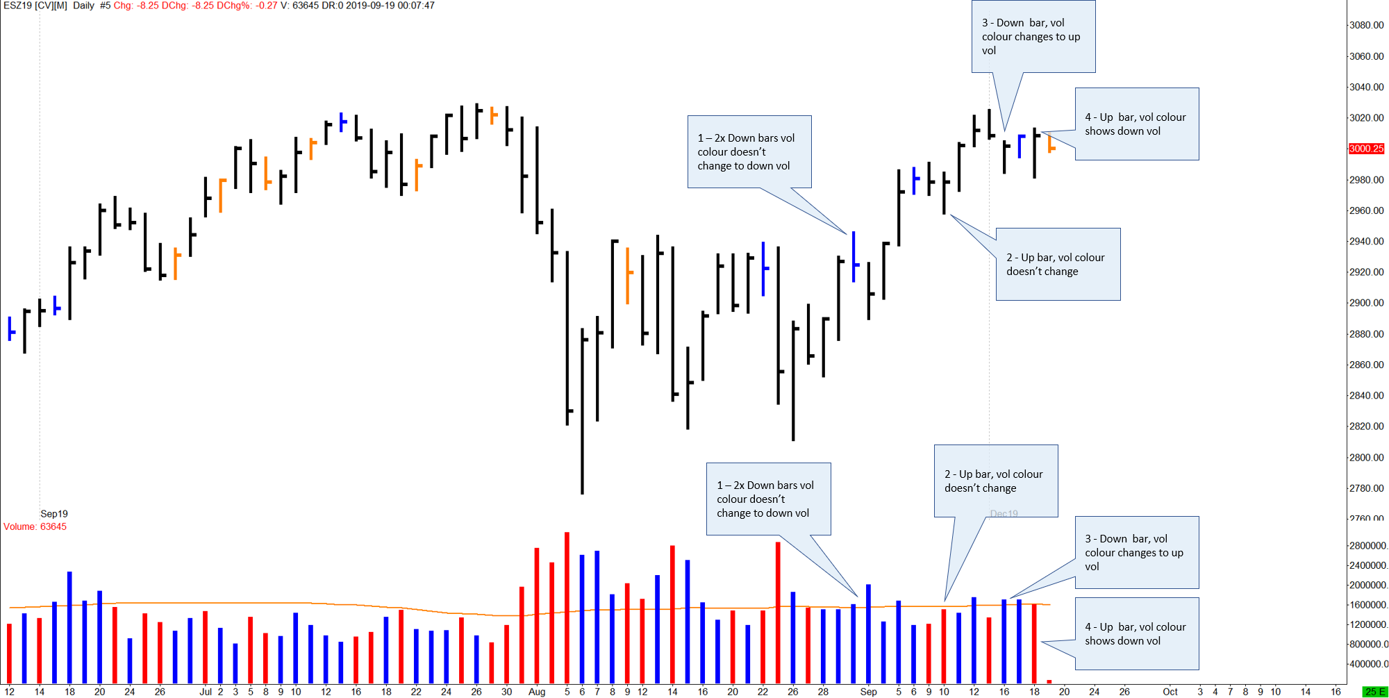

Further, the Volume study is showing inconsistent behaviour and not colouring bars appropriately where there is a change in closing price up/down. This is evident in the chart attached. Using standard volume study with auto-colouring set at 'same as base graph'. Blue = up close, red = down close.
According to the study description...."Volume bars are color coded based upon whether the corresponding price bar is up or down. To choose the up and down colors, click on the Subgraphs tab in the Technical Study Settings window and set the Primary and Secondary colors for the first Subgraph."

What we find, is that the Volume study does generally work as you want in post #1 but there is a difference, with how it is determined to be an up or down bar.
We have updated the documentation to precisely explain how this works. Refer to:
Volume
There is no problem with how the study works. It works as documented.
Date Time Of Last Edit: 2019-09-19 05:04:32

Ok, so Close is compared to the Open price, not the prior Close as I understand. Why dont you add the functionality to compare to the prior close (which is relevant for a lot trading methodologies) and at the same time add the functionality of how to manage when closes are at the same price (ie based on the prior bar close OR just treat is as an up bar OR paint it a different colour altogether as this can be important information also). This is basic functionality.

We will add a new auto coloring method to support this.
Also the study you are looking for already exists but does not handle the case when the prices are the same:
Volume - Colored Based on Bar Closes
However, that will be supported with the new auto coloring method.
