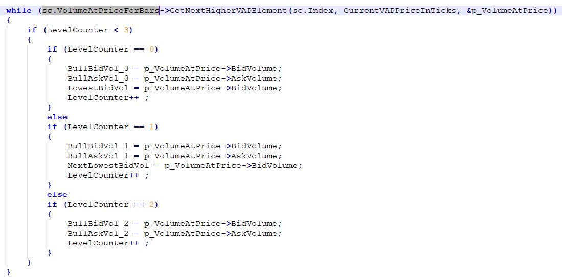

Quick question.... For most of my VAP calculations iterating from the high/low price works fine and because I mostly use fixed range bar types it is easy to specify levels I want to analyze/compare...
But what if I want to quickly specify that I want the bid/ask data from the level or 2 just above the current price... without knowing how many levels are in the bar AND without having to iterate with code to check if sc.Last == VAPlevel1, VAPlevel2, etc.... Basically is there any examples of code for getting VAPElement sc.Last+1
until now all of my code has iterated through the VAP like in the picture attached... but I've always needed to specify the exact level by H/L +/- ticks
Or is it possible to... iterate through the VAP levels using sc.Close as the starting point and iterate up and down from there... instead of starting at the H/L of the bar?
Date Time Of Last Edit: 2019-09-17 01:16:14
imageCapture.JPG / V - Attached On 2019-09-16 15:39:45 UTC - Size: 71.06 KB - 696 views
imageCapture2.JPG / V - Attached On 2019-09-16 18:02:47 UTC - Size: 34.44 KB - 532 views
