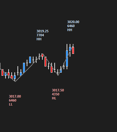

After watching the spreadsheet during many replays I have identified what I believe to be the cause.
Values in prior cells are changing at a later time (This is happening when a new swing has not started)
Example:
1 Minute Chart
18:44:00 = New Swing Starts
18:44:00 = W3 =2 (TEXT LABEL[-2])
18:44:00 = T3 = 3019.25 (Reversal price[-2])
Close Above T3 Alert Triggered
18:45:00 = W3 =2
18:45:00 = T3 = 3019.25
18:46:00 = Both prior cells change values (Now cell 4 and 5) with a new text label and reversal price and the Alerts disappear. A new swing has not started.(Even if it did, surely these previous values should not change?)
Any help in explaining what is happening would be very much appreciated. I have tried many formulas and this always seems to be the case.
I have attached 4 screenshots, spreadsheet before and after values change and charts reflecting the same.
Many Thanks

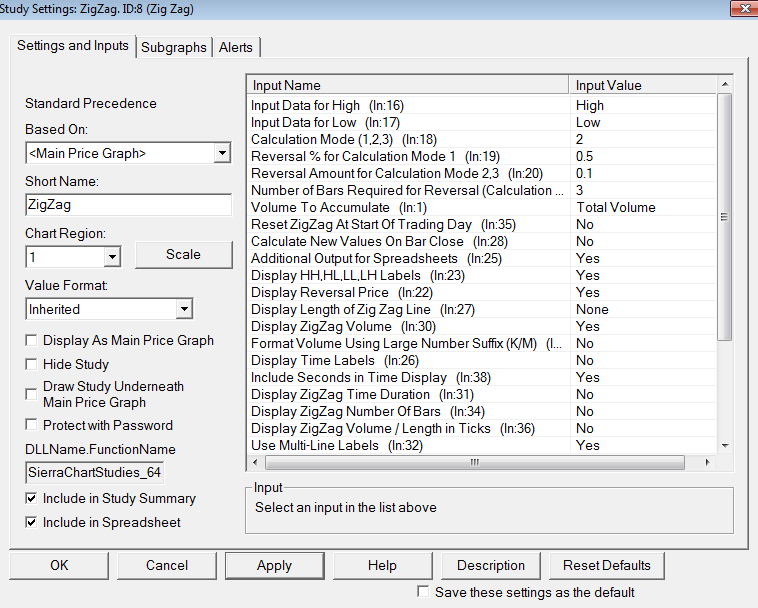

[2019-09-14 21:44:10]
Chris_uk - Posts: 89
Hi Tom,
The settings, as requested.
Symbol: S&P 500 September 2019. F.US.EPU19
Time Zone: London(+0GMT/+1BST)
ZZ Settings: Screenshot attached.
Starts at 18:44:00 2019-09-12
Thanks for your suggestion regarding the High. This was just a simple test, my system is more complex and will require many more formulas.
Many Thanks!
Date Time Of Last Edit: 2019-09-14 21:48:19

Referring to your example:
The ZZ line goes above the previous HH only intrabar in the 18:44 bar. When the 18:45 bar opens and builds, the slope of the ZZ line lessens such that its value at the 18:44 bar is no longer above the previous HH.
The ZZ line has a steeper slope in the 18:44 bar than it does in the 18:45 bar because it begins at the HL in the 18:41 bar and lessens its slope as it moves to newer HH bars.
This same thing occurs again in the 18:45/18:46 bars.
The ZZ line's higher intrabar value in the 18:44 bar is not retained, and is unavailable to be used in formulas. The only ZZ line values that are retained are values after the leg finalizes. ZZ line values of the developing leg are not retained.
