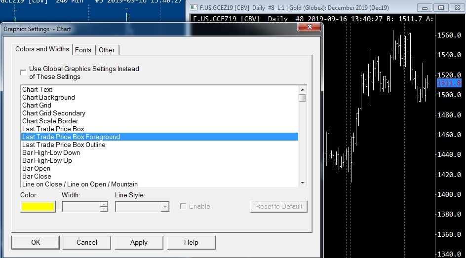

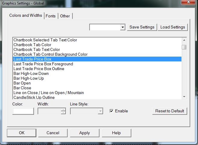

Guys, thanks for your willingness to help. However, please see attached pics. Those are my setting. So how come I have a "red" price shown on my charts? Where does that color come from? What am I missing here, please? This chart is using these settings as shown. Thank you.

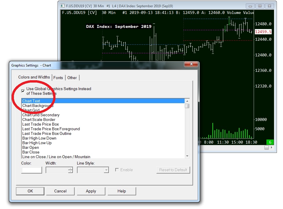

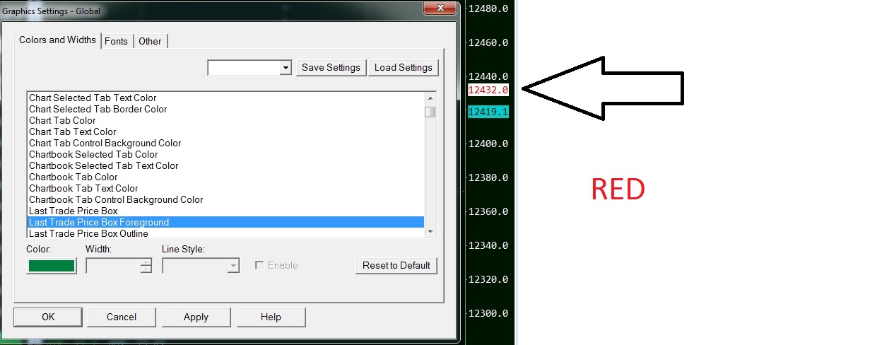

I did as advised.
I selected Use Global setting for the selected chart but I still see price colored red.
None of the settings in /Global have red selected.
I am not following...
imageSH_ 4095 Sep. 13 18.41.jpg / V - Attached On 2019-09-13 16:44:16 UTC - Size: 192.38 KB - 401 views
imageSH_ 4094 Sep. 13 18.41.jpg / V - Attached On 2019-09-13 16:44:42 UTC - Size: 144.85 KB - 513 views

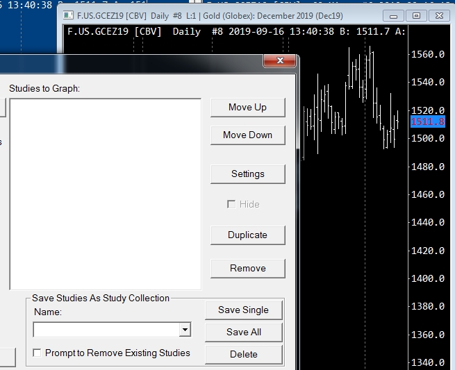

EuropeanTrader - Posts: 290
I removed all the studies. Still the same problem, price is red without any red color chosen in graphical settings.
What would be the solution?
Thanks,
Greg
imageSH_ 4103 Sep. 16 13.40.jpg / V - Attached On 2019-09-16 11:43:15 UTC - Size: 115.69 KB - 367 views
imageSH_ 4102 Sep. 16 13.40.jpg / V - Attached On 2019-09-16 11:43:29 UTC - Size: 169.72 KB - 481 views

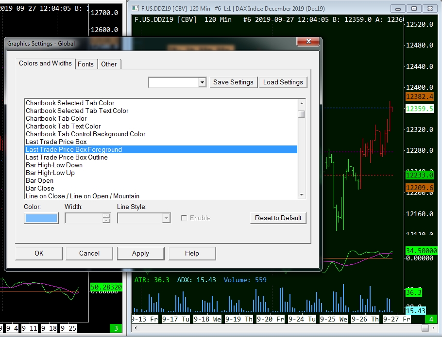

The attached chart is using "Global" settings and this is the screenshot of the Global settings - blue color chosen.
I don't see any effect on my charts, no blue.
imageSH_ 4137 Sep. 27 12.04.jpg / V - Attached On 2019-09-27 10:05:45 UTC - Size: 263.06 KB - 474 views
imageSH_ 4136 Sep. 27 12.04.jpg / V - Attached On 2019-09-27 10:05:56 UTC - Size: 269.05 KB - 375 views
