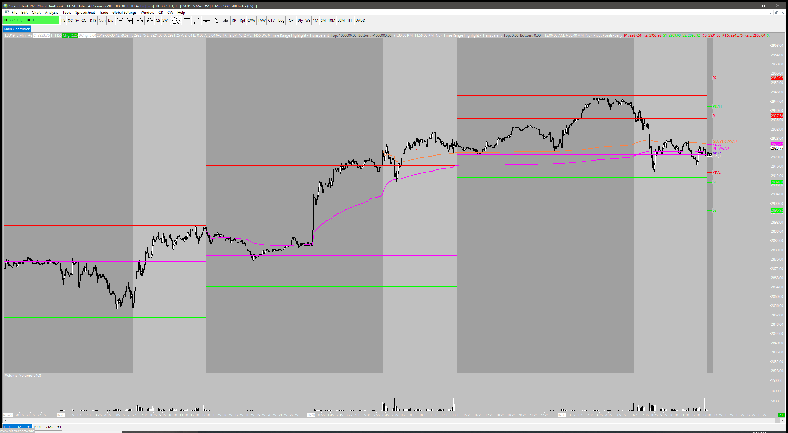

Hey guys, I've spent some time setting up my platform. I've got a few studies all dialed in correctly, except for the problem that they are not being shown historically.
I'm using the Pivot Points study that's built in. The pivots are printing historically for each day how I want.
I've used the Daily OHLC study to have the previous trading day's OHLC value shown as a level on the chart. It is printing the levels only on the current day's session, and I would like to have it show on all previous days, too.

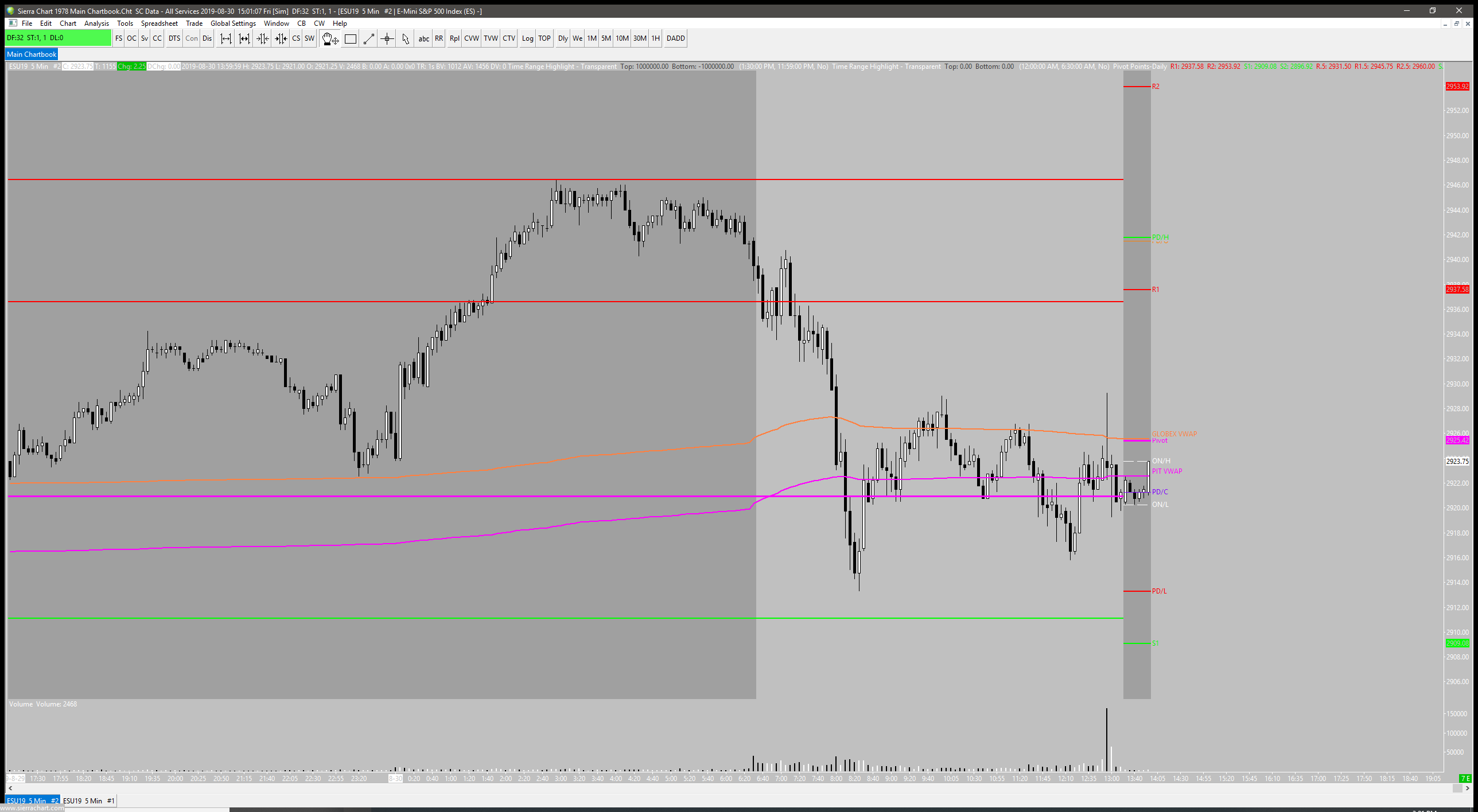

I've also used the 'High/Low For Time Period - Extended' study to have the high and low of the overnight session shown. It is correctly plotting the H/L during the current overnight session, and into the day. Once the market closes and we move into the next overnight session, the plots disappear and new plots for the current ON session start plotting. The ON H/L are the white lines in my included picture, I'd like to see these levels historically, not just the current ON high and low.
Also, I have two VWAP's on the chart. I can't get them to show historically, either. They're calculated based on the current day, and based on overnight+day. I've tried changing all sorts of settings, but any change is messing with their actual values. I want these to be calculated and printed for each day historically. I've looked at the VWAP documentation, and I don't see any way to do this, so I'm not thinking it's possible, but worth a shot. I'm not sure I have them setup correctly.
Also, would it be possible to have the Pivot/R1/R2/S1/S2 labels put on the historical pivot points? They're only showing for the current pivot levels.
I've included pictures, and a chartbook, so you can see all the studies. For reference in the pictures, the darker highlighted sections of the chart are the overnight session, and the lighter ones are the trading session.
Any help or guidance would be greatly appreciated! Hope you guys have a good weekend :)

[2019-09-03 10:36:09]
None of this is making any sense. If this is the case, then it means that you deliberately set the Number of Days to Calculate Input with those studies to 1. Did you? Or are you using a Chartbook from someone else?
How could you have overlooked that Input setting? It would be far easier to simply adjust that, rather than writing all of this.
