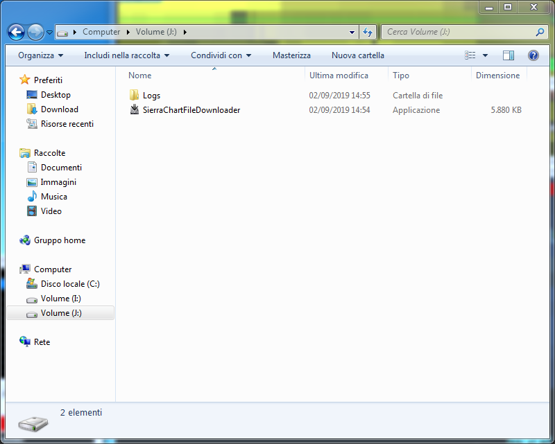

[2019-09-02 13:02:51]
User657945 - Posts: 226
I was folling the procedure indicatred by you I downloaded Sierra from your site and saved to the new SSD disk, then I push install but it is still installed on C and running automatically from C primary disk.
No istance of Sierra were open and I don't know if it matters or not I'm in live demo till sept 6.

Date Time Of Last Edit: 2019-09-02 15:43:33
imagenew folder.PNG / V - Attached On 2019-09-02 15:43:24 UTC - Size: 91.93 KB - 437 views
[2019-09-03 06:03:38]
Hi Can you please tell me if I'm doing something wrong or what's the problem is please?thx

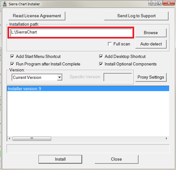

[2019-09-03 15:08:10]
User907968 - Posts: 885
Did you change the installation path in the Sierra Chart Installer? I suspect not.
[2019-09-03 15:10:29]
I did I also attached the photo with the new folder, that is why I'm asking for support
[2019-09-03 15:24:50]
You changed the path in the red box in the attached image?

[2019-09-03 15:29:54]
Uhmm that's a good point I changed the folder where I downloaded the installer file but probably not the ones you are indicating. I will check thx a lot
[2019-09-03 15:39:51]
Thank You User907968 that was the issue now I will move the data files when the platform will be closed . So for support the case it is solved.Alberto
[2019-09-04 03:17:37]
Yes you need to change the Installation Path on the Installer to where you want to install Sierra Chart before pressing Install. So looks like you want to use J:\SierraChart
