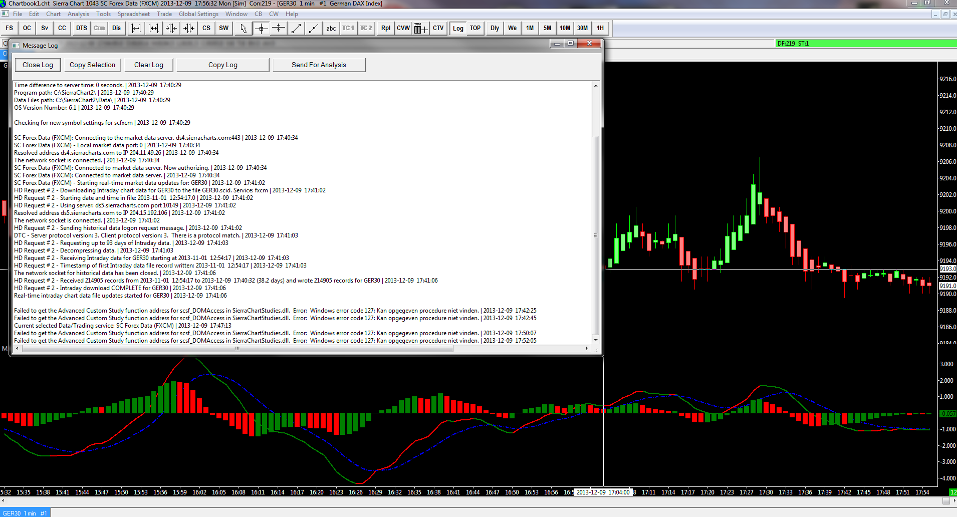

I am working now with the free datafeed CFD of yours/FXCM. However, every time when I try to add a study with F6 I get a message, see below. I don't understand. I can add this study to my charts, that's not the problem, everything seems to work fine but I want to know to resolve these messages because I doubt if everything is working well now? .
Failed to get the Advanced Custom Study function address for scsf_DOMAccess in SierraChartStudies.dll. Error: Windows error code 127: (dutch) Kan opgegeven procedure niet vinden. | 2013-12-09 17:42:25
For your convenience also a message log I hope you can help me.
Thanks,
Ruud

Failed to get the Advanced Custom Study function address for scsf_DOMAccess in SierraChartStudies.dll. Error: Windows error code 127: Kan opgegeven procedure niet vinden. | 2013-12-09 17:42:25
Failed to get the Advanced Custom Study function address for scsf_DOMAccess in SierraChartStudies.dll. Error: Windows error code 127: Kan opgegeven procedure niet vinden. | 2013-12-09 17:42:45
Current selected Data/Trading service: SC Forex Data (FXCM) | 2013-12-09 17:47:13
Failed to get the Advanced Custom Study function address for scsf_DOMAccess in SierraChartStudies.dll. Error: Windows error code 127: Kan opgegeven procedure niet vinden. | 2013-12-09 17:50:07
Failed to get the Advanced Custom Study function address for scsf_DOMAccess in SierraChartStudies.dll. Error: Windows error code 127: Kan opgegeven procedure niet vinden. | 2013-12-09 17:52:05
Failed to get the Advanced Custom Study function address for scsf_DOMAccess in SierraChartStudies.dll. Error: Windows error code 127: Kan opgegeven procedure niet vinden. | 2013-12-09 17:58:48
Failed to get the Advanced Custom Study function address for scsf_DOMAccess in SierraChartStudies.dll. Error: Windows error code 127: Kan opgegeven procedure niet vinden. | 2013-12-09 18:01:10
Failed to get the Advanced Custom Study function address for scsf_DOMAccess in SierraChartStudies.dll. Error: Windows error code 127: Kan opgegeven procedure niet vinden. | 2013-12-09 18:11:56
imageSC.png / V - Attached On 2013-12-09 17:08:06 UTC - Size: 164 KB - 659 views
[2013-12-09 17:27:34]
Update to the current version of Sierra Chart by selecting Help >> Download Current Version.
After this add the Depth of Market Data study.
