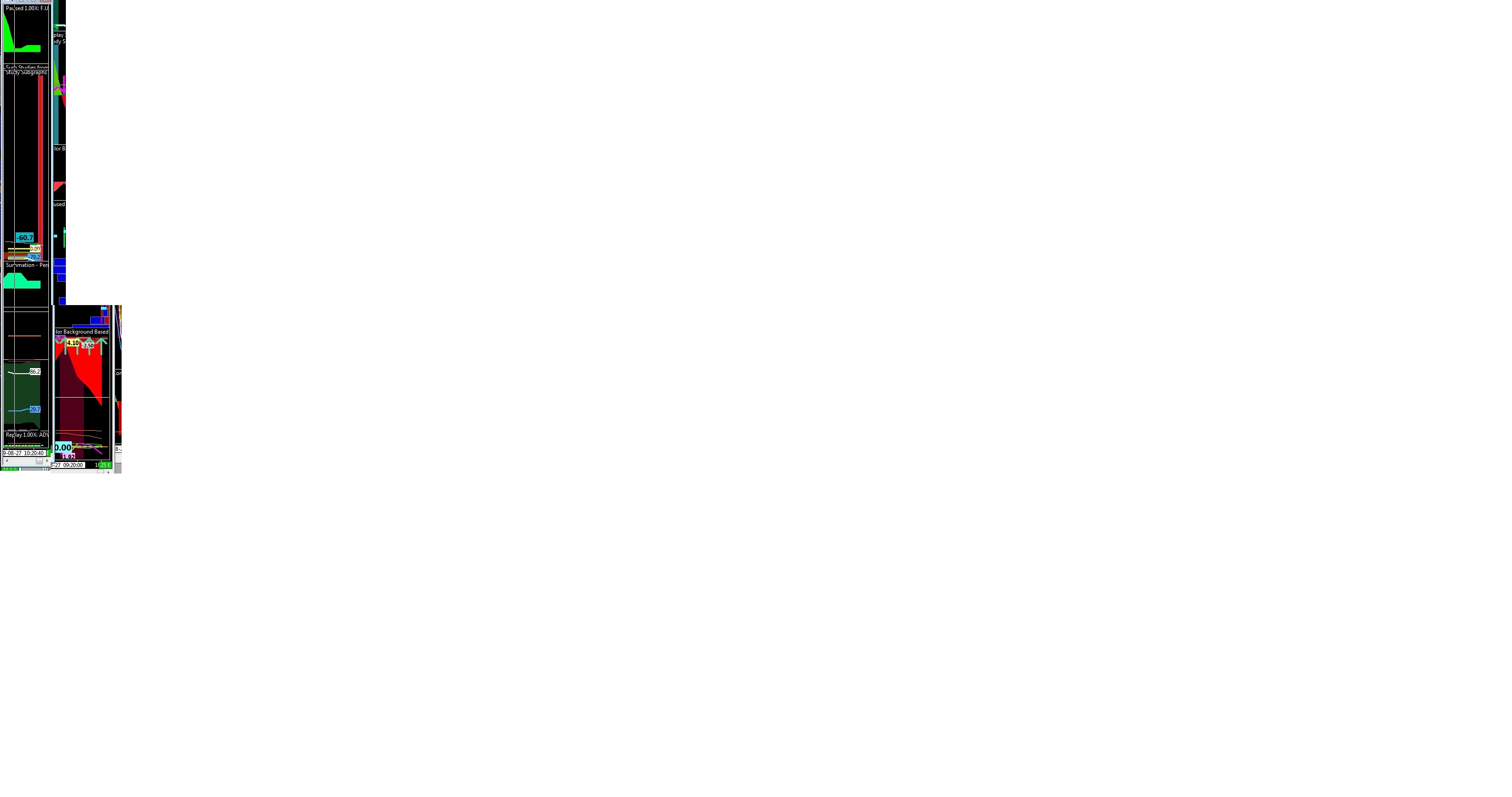

ADDED: Subgraphs also are snapping to same 1 tick .25 with crosshair readings, as if subgraph was entirely based on Main chart. This is unusable, as many subcharts' levels are in decimals and
tool Lines must be marked at decimal levels.. they also are snapping by .25.
Most regions have several studies overlaid, each with slightly different ranges. I can't view any of that properly. Some of these look more like Independent or "same as region" scales. Completely unlike what I had, and not adjustable. See example pic: (I could show you the prior, if you want)
Date Time Of Last Edit: 2019-08-28 14:03:28
imageVers1957RegionsWontAdjust.jpg / V - Attached On 2019-08-28 14:03:12 UTC - Size: 159.53 KB - 520 views

This does not make sense. You can access the scale settings for an individual study by following the instructions here:
Chart Scale and Scale Adjusting: Opening the Scale Settings Window For a Study
Changing the scale of the study is not going to affect the main price graph unless it is in the same chart region, and using a Scale Range of Automatic. In that case the scale will expand as necessary to accommodate the scale of the study
Although we do see a problem when using a Constant Range Scale with studies where the initial scale is not correct. This will be corrected in the next release. But this does not affect the main price graph.
Date Time Of Last Edit: 2019-08-28 17:00:45

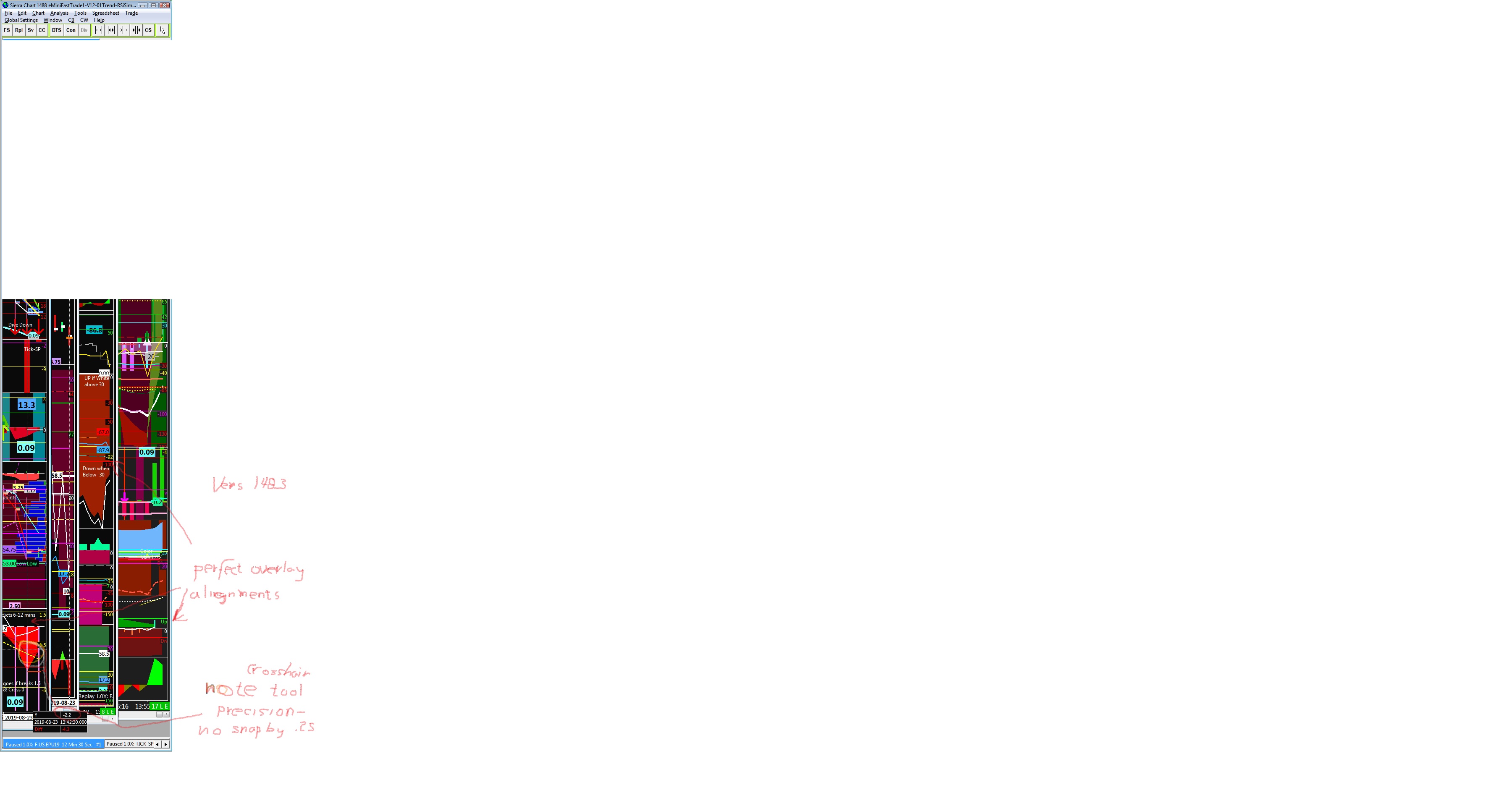

EDIT: See Vers 1483 Pic of same Chartbook area (as pic of V1957 I first showed): Vers 1483 here shows overlayed studies perfectly-aligned, with precise tool reading of 2.21 not snapping.
You may need to Zoom or open with old MS Paint.
EDIT2: Once I set all 7 substudies the same scale (not Automatic), the border slider works for those and the snap stops snapping and the appearance is near V-1483.
But apparently sliding the scale causes them all to revert to Automatic. Maybe that's the "Automatic" issue you cited.
We need a master Option "by Region" or "By Study" where scale button is on Studies list-- to allow either by study or by region (that to act like V1483), or just go back to 1483's scaling code.
Date Time Of Last Edit: 2019-08-29 15:27:22
imageVers1483RegionsPerfectAlignmentAdjust.jpg / V - Attached On 2019-08-29 12:31:16 UTC - Size: 369.54 KB - 527 views
