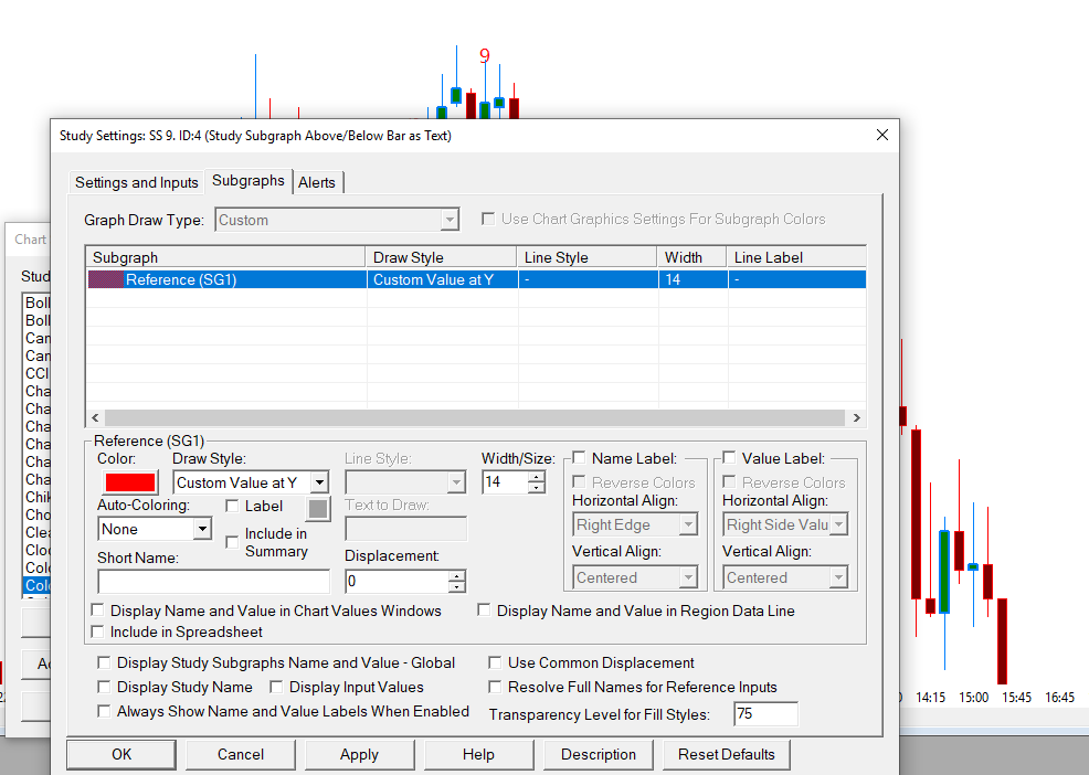

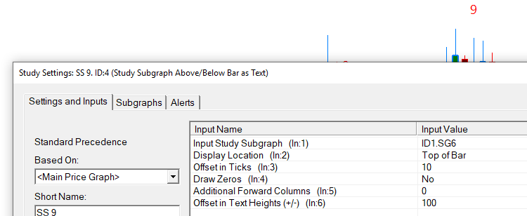

I cannot get the offset in text height(+/-) to work with my charts. I am pulling a value from the spreadsheet study and using the study subgraph above/below bar as text study. attached are pics that show i am trying to offset the number "9" above the bar. i tried different tick offsets but none work. in the pic, i used offset of 100 and the "9" does not move. What am i possibly doing wrong. you mentioned before that the offset is working.
update: I was just playing around with the offset in ticks(ln:3) and that was moving it away from the bars. What is the difference between offset in text heights (+/-)(ln:6) and offset in ticks (in: 3)?

[2020-05-09 01:06:50]
We will resolve the problem with that Study Input not working with the particular Draw Style being used (it works with the Transparent one), in the next release.
And we have also added documentation for it.
