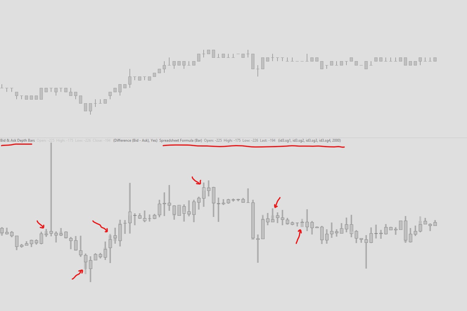

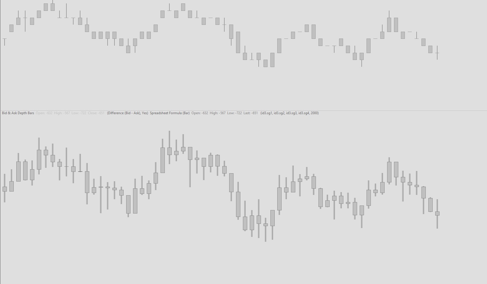

There are big discrepancies when using Spreadsheet formula study with Depthbars study on live data. After reloading chart those discrepancies disappear.
Screenshot BEFORE show original depthbars study as light gray fat candles, and overlayed hollow candles above them is simple spreadsheet study using straight OHLC values of depthbars study.
Screenshot AFTER is the same chart after reloading.
What is the reason of those discrepancies? Spreadsheet study has "Very Low Precedence" and Depthbars study has "Standard Precedence", so spreadsheet formula shouldnt have different values!

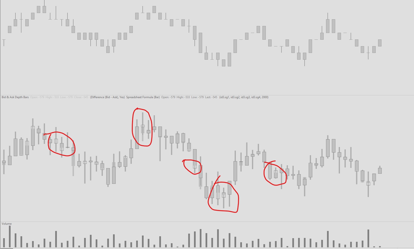

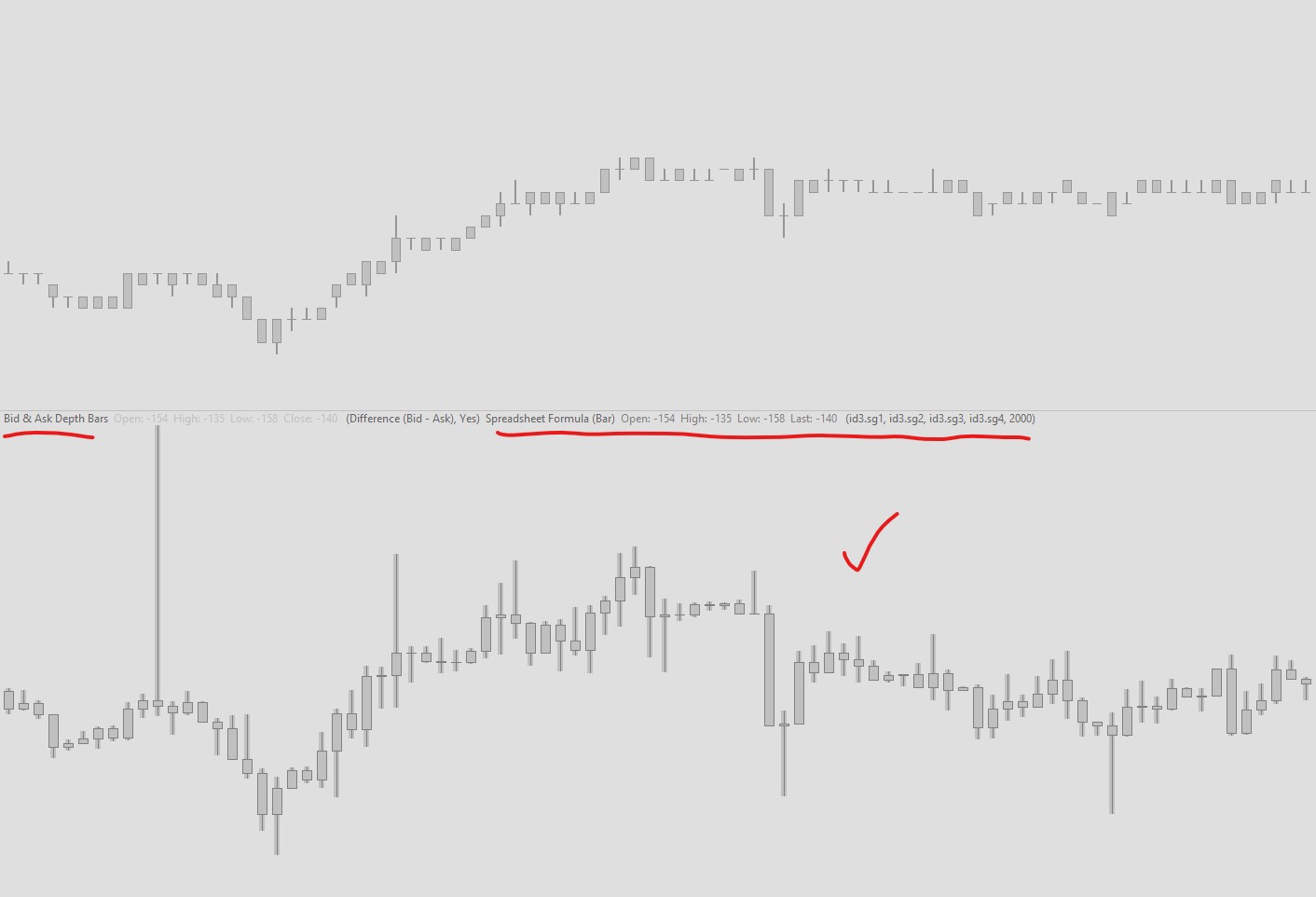

I see you made an update addressing this issue. Unfortunately the solution is rather dirty, cause you recalculate previous bar after new bar is already being ploted. Markets dont go backwards right?
Nevertheless problem of wrong values being used by spreadsheet formula is still present when there are other studies on the chart.
First screenshot is clean chart just with only Depthbars study and Spreadsheet formula study. Spreadsheet study seems correct (despite the fact that recalculation after new bar is already plotted...)
But second screen is the same chart with just Volume study added. All gets messed up again as it was in previous builds and spreadsheet study still has wrong values! Even though that delayed recalculation.
After recalculating the chart all gets to normal - third screenshot. The problem is only with live data.
