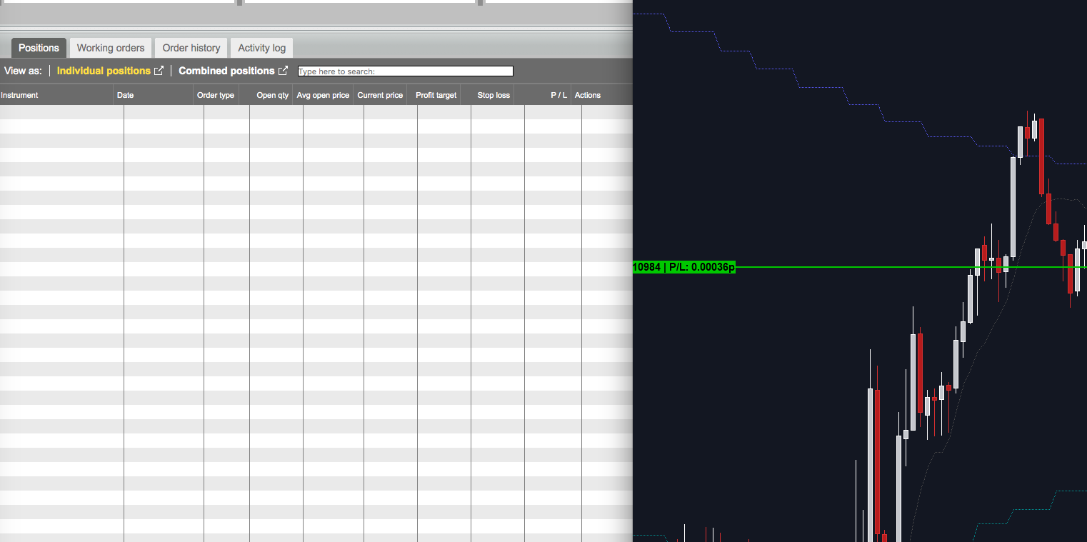

Mack - Posts: 83
Sierra Chart shows I have a position open, but this does not reflect in LMAX.
(at LMAX I have no positions).
Can you please reset my account at the Sierra Chart server, so the positions
are correctly synced? Please note that I make use of the Sierra Chart custom
API integration.
imageScreen Shot 2019-08-21 at 10.21.15 AM.png / V - Attached On 2019-08-21 17:37:05 UTC - Size: 65.4 KB - 470 views
[2019-08-21 18:21:40]
This is easily corrected. Refer to the steps here for this and for an understanding of why you see this:
LMAX Trading Service: How Current Trade Positions Are Determined
Date Time Of Last Edit: 2019-08-21 18:22:00
[2019-08-21 19:13:52]
Mack - Posts: 83
Thanks!
So to fix this:
- You dive into the Trade Activity log, filter on right symbol.
- Try to delete a few fills to make sure which fill is the wrong one.
- Reconnect to get all fills back.
- Delete the ghost fill.
- Copy the Date-Time from that fill, add say one hour, and put that in "Order Fills Start Date-Time"*.
After this, my ghost fill went away and didn't come back.
* Chart >> Chart Settings >> Advanced Settings >> Order Fills Start Date-Time.
Date Time Of Last Edit: 2019-08-21 19:20:18
[2019-08-21 19:25:00]
We do not recommend going through all of this. And you should not have a "ghost fill". What does that mean? It would be incredibly surprising if there is actually a true "wrong" fill. If there is we would have to ask LMAX about that. That would be a serious issue.
You just need to adjust Chart >> Chart Settings >> Advanced Settings >> Order Fills Start Date-Time to the present time if at the present time you are flat the market for the symbol.
[2019-08-21 20:38:22]
Mack - Posts: 83
ActivityType DateTime Symbol OrderActionSource InternalOrderID ServiceOrderID \
OrderType Quantity BuySell Price Price2 OrderStatus FillPrice FilledQuantity TradeAccount\
OpenClose ParentInternalOrderID PositionQuantity FillExecutionServiceID HighDuringPosition \
LowDuringPosition Note AccountBalance
Fill 2019-08-20 21:40:01.000 EURUSD LMAX Live Trading - DTC historical fill (LMAX order update (Trade))
298693 1 Buy Filled 1.11035 1863020838 bwtxJgAAAARwqvVv
This is the offending entry. (that I managed to get rid of with the above procedure). I called it a ghost fill, because SC thinks we are currently short (-.1 on EURUSD). However, there is no short open position in LMAX. Ghost fill is not an accurate description, I understand now. I think, SC somehow did not download the opening fill, and kept showing a short position even though I already closed the trade.
Yesterday I had a short position that I flattened. This morning I opened up SC, and I still saw a 'buy stop', that I put in through the web interface of LMAX. I think this buy stop was associated with AAGJHQAAAANCX5EM. I hit flatten, and I created a losing trade short (AAGJHQAAAANCYaaG entry, exit AAGJHQAAAANCYadZ). After this, I still saw this 'ghost' position in SC even though there was nothing open in the web interface.
I think this has happened because I entered the stops through the webinterface, and then press flatten later?
update: my 'ghost fill' doesn't appear anymore, after deleting and reconnecting. It seems that the corresponding opening fill (bwtxJgAAAARwqhsZ) now is downloaded too, so my "ghost" fill (bwtxJgAAAARwqvVv) is properly offset.
