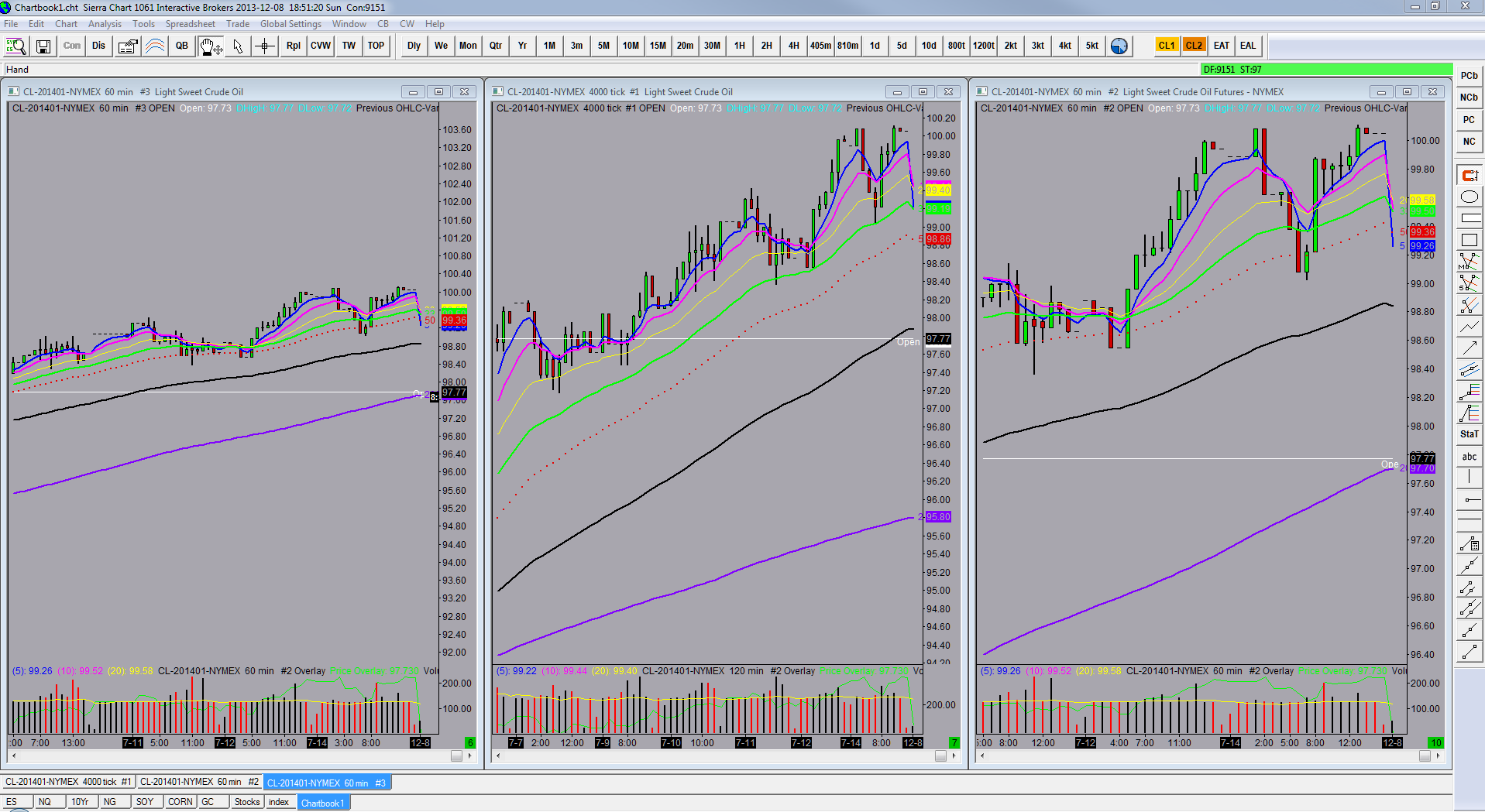

I'm attaching a picture that shows 3 intraday charts...problem is the one on the right. It is continually cycling between 120 and 60 minute charts. It begins after I selected the daily timeframe and only stops if I shut the window. I'm also attaching the log file.
This happened on my ES workspace friday and now it's CL.
I have done a full server download and full reset. Btw, I have ONCE AGAIN, lost every custom intraday chart session time and I must do it all over again.
Also note, there is no [M] on the chart. Why not?

[2013-12-09 01:22:29]
There was no reason to reset the symbol settings in this case. It is wholly unrelated to the problem you are having. Refer to help topic 30.3 here:
http://www.sierrachart.com/index.php?l=doc/helpdetails30.html#h30.3
Next time please ask us first about this.
In regards to [M] , do you have Global Settings >>Data/Trade Service Settings >> Allow Support for Sierra Chart Data Feeds enabled? And are you connected to a Live Interactive Brokers account?
Date Time Of Last Edit: 2013-12-09 01:23:16

btw, I found the study that was causing issues..my error...
thnx
