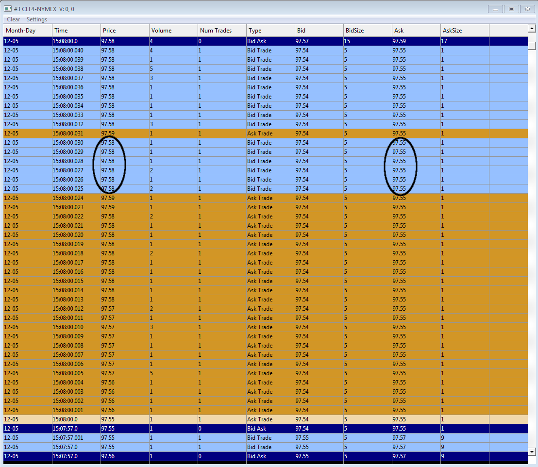

I see some inconsistencies using T&S for CLF4-NYMEX /pls. see the picture/
There were some trades at the bid but(and) above the ask and vice versa.
Would you please consider the issues to resolve them.

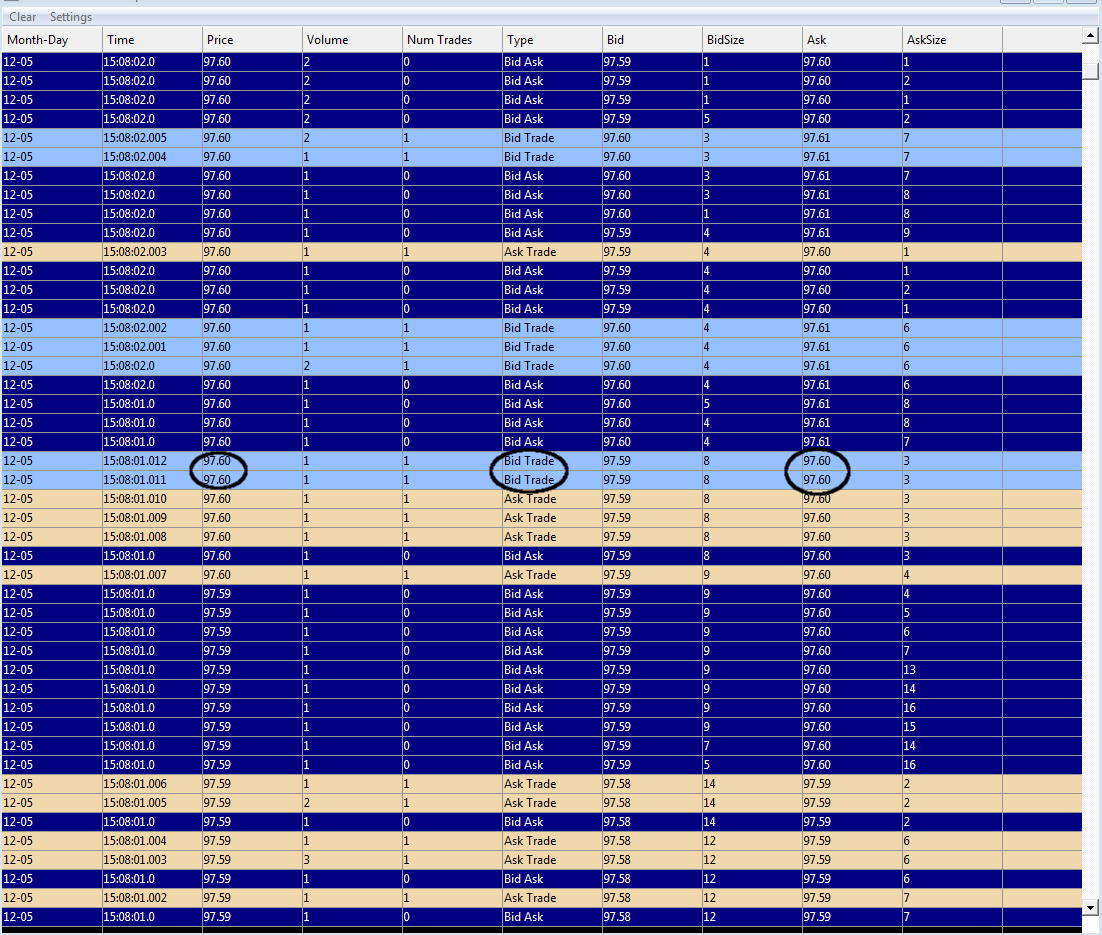

ganz - Posts: 1048
SC Support
He's trying to bring your attention to the last/bid/ask values:
T&S #3 /cos12.png/:
last 97.58
bid 97.54
ask 97.55
and so on
Thank you.

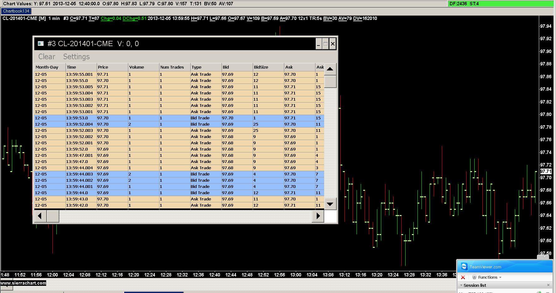

[2013-12-05 19:13:52]
Corefan - Posts: 13
http://www.sierrachart.com/image.php?l=1386269999663.png
13:59:52.004 97.70 vol 2 Bid trade Bid- 97.69 Ask 97.70
Is that correct?
[2013-12-05 19:26:19]
Yes, we believe this is correct because we use what is known as the "Aggressor" field in the fast fix feed from the CME to determine whether the trade was at the bid or the ask. This is going to be the absolute most accurate way to determine this. This is one advantage when using the Sierra Chart real-time futures data feed.
Due to the timing of the transmission of the bid and ask data from the CME, there could be a slight discrepancy sometimes, when you actually compared to the bid and ask prices.
Date Time Of Last Edit: 2013-12-05 19:29:17
[2013-12-05 19:33:10]
We are looking over the first image now added to post #1. Not certain about the why the bid and ask prices were not correct earlier. That appears to have been a CME data feed problem. But we will think about if there is anything that could possibly be on our side .
In regards to the second image as to the identification of whether it is a Bid trade or Ask trade, once again we use the aggressor field and that this is the most accurate way.

[2013-12-05 19:38:02]
ganz - Posts: 1048
Corefan
FYI: Announcement: New Sierra Chart Real-Time Futures Data Feed (CME, CBOT, NYMEX, COMEX data) | Post: 17971
We would also like to comment on Cumulative Delta-Volume with this new Sierra Chart real-time futures data feed.
The CME data feed provides a field called "Aggressor". We use this field, to identify whether a trade is considered at the bid or ask.
Using this field is the definitive method to do this rather than comparing the last trade price to the bid or ask. This aggressor field is passed straight through from our server which gets it from the CME data feed, into Sierra Chart.
We have noticed that the Cumulative Delta values are slightly different than IQ Feed. The graph appearance is the same. Therefore, what we provide is the definitive reference and is 100% accurate. You cannot achieve any better accuracy than what the Sierra Chart data feed offers.
Looks like there is no hard link to a last price in this case.
This is something new for anybody who reads a T&S. Hm...m
