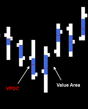

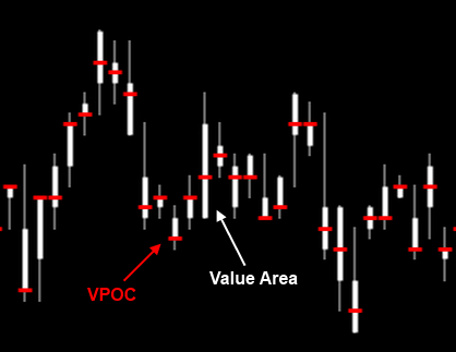

Hello. I'm new to the Sierra Chart (I wanna switch to it from another software) and I've got some question about VbP study. I need to make a layout like on the screens below, but I can't configure it. I wanna see per-bar volume point of control and value area, but without profile for each bar. Is it possible with this study?

The Volume Value Area Lines study can give you something similar if you are using time based bars. If for an example you are looking at 30 minutes bars then in the Setting and inputs enter "Minutes" for the "Time Period Type" and enter "30" for the "Time Period Length". Also, in the Subgraphs, make sure to choose "Dash" for the Line Style. what you will get is small Horizontal lines for the VAH/VAL/POC of each bar. You can use the Width/Zise to adjust the thickness of those lines.
