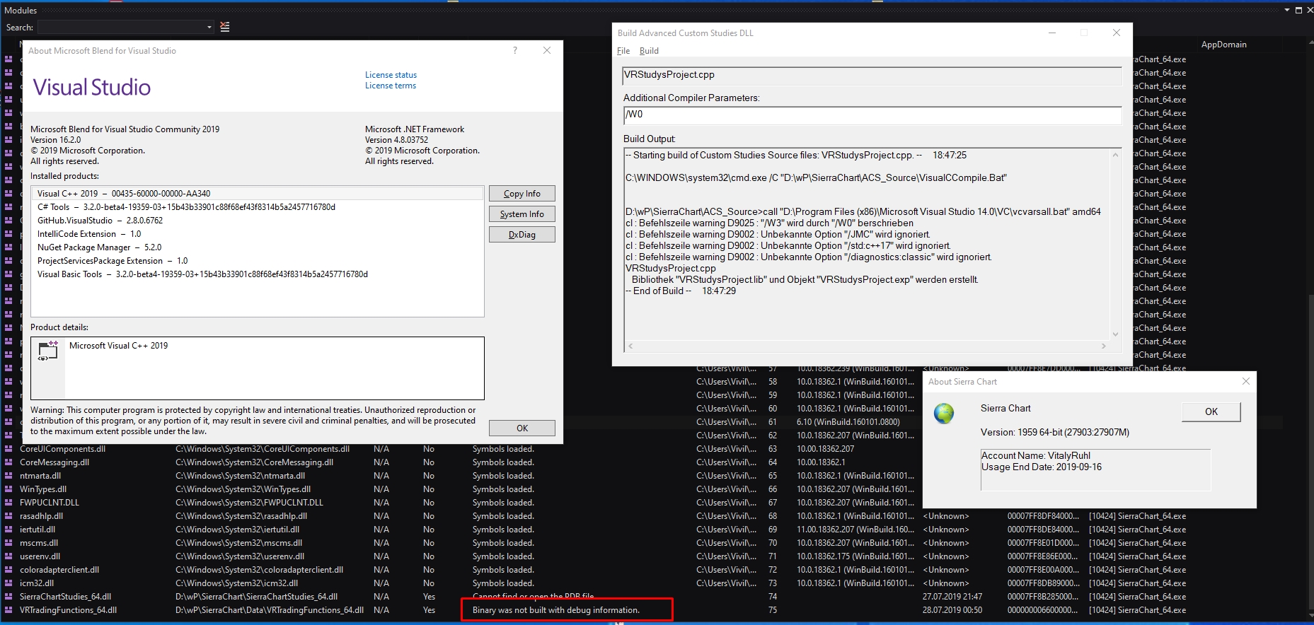

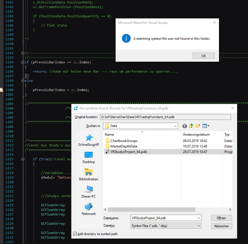

i have problem to debug.
my breakpoints will not hited. The error message is:no symbol have been loadet for this document.
I have compiled with Debug option. And there is a file with ext. pdb... See attached screenshots.

imagesc1.jpg / V - Attached On 2019-07-28 17:06:17 UTC - Size: 887.62 KB - 498 views
imagesc2.jpg / V - Attached On 2019-07-28 17:06:24 UTC - Size: 298.73 KB - 532 views

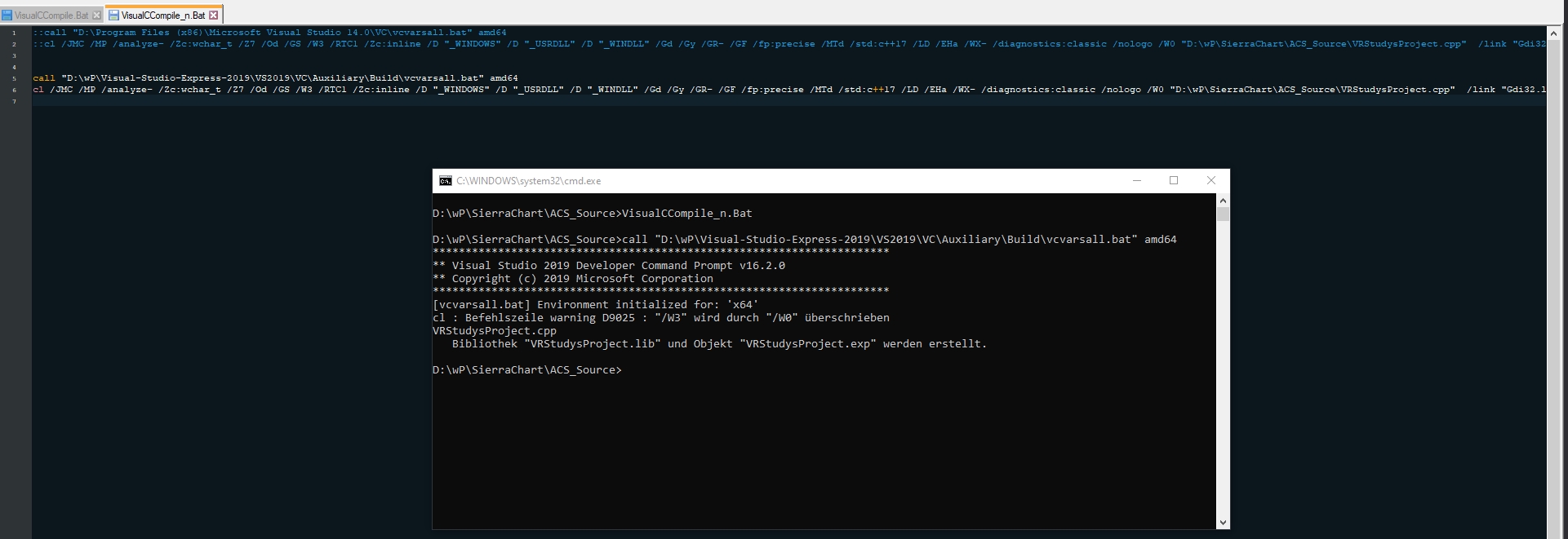

I still tried that...
I change the the first line in VisualCCompile.Bat to my VC installation (see screenshot).
That compile the code fine and makes new .pbd file.
but it dont work to.... The same Error: Binary contains no symbol informations....
imagevc1.jpg / V - Attached On 2019-07-29 18:28:01 UTC - Size: 319.01 KB - 475 views
