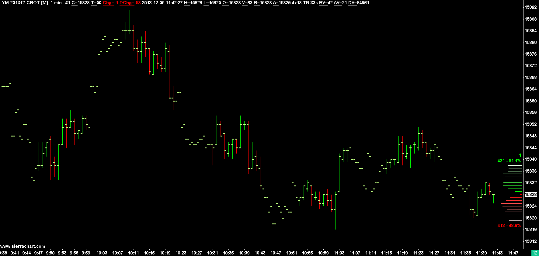

[2013-12-04 20:39:55]
jsoviero - Posts: 84
Hello Support,
Yesterday I was able to view charts and trade the symbol YM-201312-CBOT[M], but today they are frozen.
I am able to open charts for symbol YM-201312-CME[M] and those charts are streaming data but I am not able to enter orders from my SC platform, I get the error message that the symbol is incorrect.
I have no problem viewing charts and entering orders for the symbol NQ-201312-CME[M]
Please suggest what I am doing wrong, Thanks
[2013-12-04 20:53:54]
We can see you are on version 1058. You need to be on this version or higher.
Update the symbol settings as explained here:
http://www.sierrachart.com/index.php?l=doc/doc_GlobalSymbolSettings.php#UpdateSettings
After that reconnect to the data feed with File >> Disconnect and File >> Connect to Data Feed. You should be OK at this point using the symbol YM-201312-CBOT. Please confirm.
Date Time Of Last Edit: 2013-12-04 20:54:07
[2013-12-04 21:20:51]
Hello support,
Followed those instructions "Update Global Symbol Settings" with no success. I tried both the first and the alternative suggested instruction and also closed SC and restarted each time. Prior to the NY close the symbol YM-201312-CME[M] was updating but the symbol YM-201312-CBOT[M] was not updating and appeared frozen although all other aspects of the chart were fully functional.
Since market is closed now I am not able to further test. Please advise? Thanks
[2013-12-04 21:43:25]
Checking on this.
We think it has to do with having charts open for both YM-201312-CME and YM-201312-CBOT. We are going to run a test.
[2013-12-04 23:07:34]
Yes, my broker Howard Lender of Deep Discount Trading initially suggested that I delete all YM charts and then add back only the CBOT charts. I did this but the CBOT charts were still not updating.
[2013-12-04 23:16:02]
Could you restart Sierra Chart and post a copy of your Message Log, by following these steps here:
https://www.sierrachart.com/index.php?l=PostingInformation.php#log

We are able to get market data for that symbol when using TT:
http://www.sierrachart.com/image.php?l=1386261751537.png

The problem is all resolved now. Update to version 1059 and perform a full reset of the symbol settings as explained here:
You will need to disable Global Settings >> Data/Trade Service Settings >> Use CME Gateway for CBOT Symbols.
Make sure that all of your YM charts are using CBOT. After all of this, then reconnect to the data feed if you were already connected.
