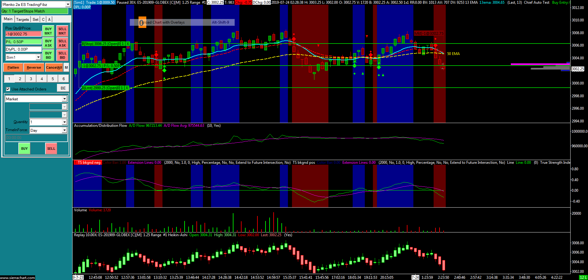

This is a very simple Alert being used,
=CROSSFROMABOVE(ID18.SG1,ID19.SG1)to create a Color Bar Alert ID14.SG1
=ID14.SG1@3>0 is entered in cell M3 for Sell Entry
The Color Bar Alert is set to -Evaluate on Close-. The Alert appears under the correct conditions, the trade arrow appears under the Alert indicator (Diamond) but the trade entry is not on the next bar but on the second bar after the alert.
[2019-07-24 09:03:37]
John M - Posts: 189
http://www.sierrachart.com/image.php?Image=1563958899813.png
Here is the screenshot of the above
Your assistance is greatly appreciated.
