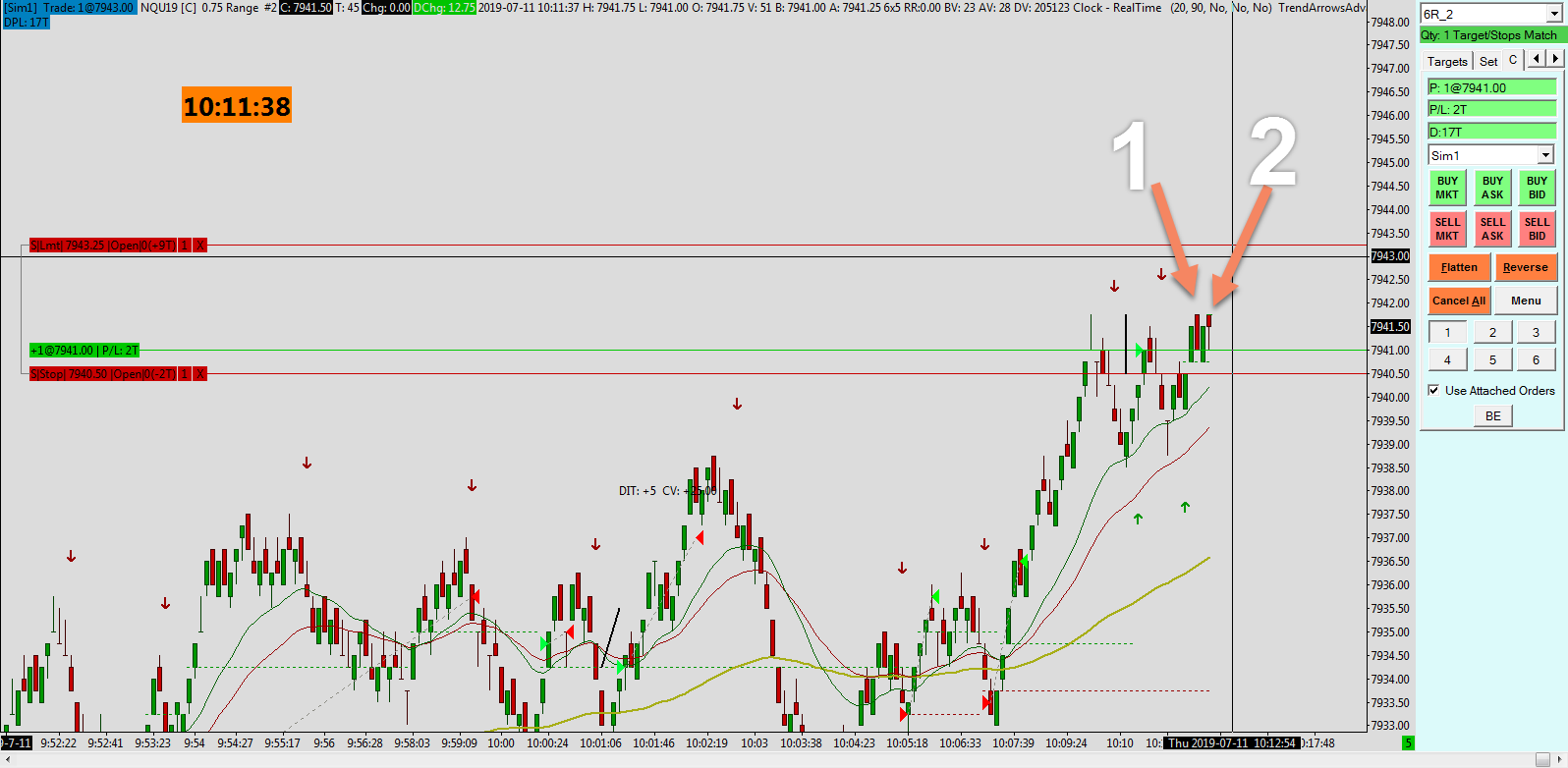

I have set a condition in ACSIL when sc.MaximumOpenPositionProfit >= 5 ticks, SL is adjusted. It works well during reply but during SIM, the action is sometimes not triggered as soon as the open profit reaches 5 ticks but later the second time the position reaches that open profit.
It is shown on the screenshot attached. At the high (1) the action should have been triggered but nothing happened. As soon as the market reached the same price again at high (2) the action was finally triggered. It does not makes sense since max pos PL at (1) = max pos PL (2)
How is the sc.MaximumOpenPositionProfit calculated (evaluated) then really?
Do I miss something?

[2019-07-11 20:21:19]
There is no variable sc.MaximumOpenPositionProfit
It is part of this structure:
s_SCPositionData::MaximumOpenPositionProfit
You need to debug the issue and log the values that you are getting and see what the problem is. Refer to:
ACSIL Interface Members - Functions: sc.AddMessageToLog()
Also refer to:
Step-By-Step ACSIL Debugging
