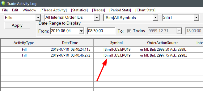

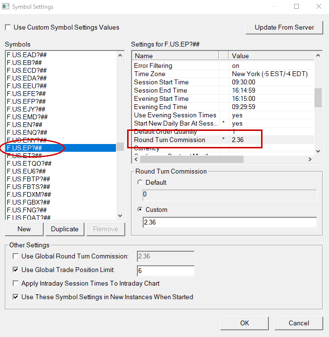

Tell us the symbol in the Trade Activity Log and the exact symbol or symbol pattern you set the commission on.
[2019-07-11 21:30:05]
Gustavo - Posts: 81
I'm attaching a screenshot of the Symbol Settings... as you can see, I set a commission rate for F.US.EP. Note I left the Global Round Turn commission unchecked as I felt it should not affect the calculation. Also, attached you will a screenshot of the Trade activity log showing the corresponding F.US.EP symbol.
Hope this sheds some light into the issue. Thanks.
image2019-07-11 16_14_59-Window.png / V - Attached On 2019-07-11 21:28:24 UTC - Size: 43.26 KB - 485 views
image2019-07-11 16_23_34-Window.png / V - Attached On 2019-07-11 21:29:42 UTC - Size: 17.44 KB - 399 views
[2019-07-11 22:25:50]
John - SC Support - Posts: 47538
You need to enable the option for Use Custom Symbol Settings Values in the upper left corner of the Global Symbol Settings window. Otherwise, it is not using any of the custom values that you have entered, including the Round Turn Commission.
Refer to the documentation on that setting here:
Global Symbol Settings: Use Custom Symbol Settings Values (Global Settings >> Symbol Settings)
