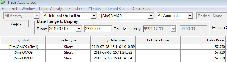

[2019-07-08 14:59:05]
User657944 - Posts: 173
trade log as attachment limit reached
Date Time Of Last Edit: 2019-07-08 14:59:25

[2019-07-08 17:29:58]
The Trade Activity Log is showing the symbol as QM.
There should definitely not be any problem with this anyway as long as you have set the Trade and Current Quote Symbol to what you want to trade.
Date Time Of Last Edit: 2019-07-08 17:30:25
Sorry but if you look into the activity log you will see that the symbol that is traded is the CL since the Qm cannot execute that prices there will never be possible to have a 58.03 simply because the QMQ9 is 58.25 or 58.00 or 58.125 because that is the the tick size.
So in fact the trading activity it is showing a trade calling it QM but it is a trade on CL full contract.I "need" the chart to execute the QMQ9 based on CL signal.
Date Time Of Last Edit: 2019-07-08 18:07:24
[2019-07-08 18:23:40]
If the symbol you see in the Trade Activity Log is for QM, that is the actual symbol traded. Do not think otherwise because that is just not the case at all. To be clear you are not trading CL.
And you need to adjust the Tick size appropriately in the chart for that symbol.
Date Time Of Last Edit: 2019-07-08 18:23:59
