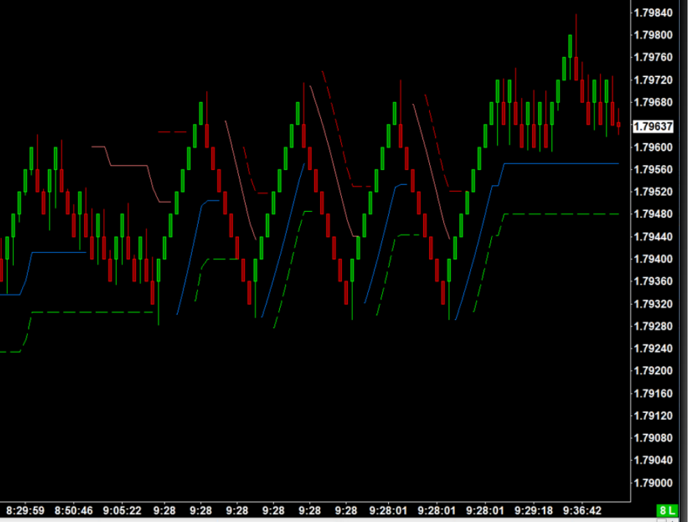

We needed some time to go over this. There are several things we need to consider and you have written a lot.
I am using one second for stored data as opposed to tick by tick. I have been trying to avoid using tick by tick because of the sheer volume.
You must use 1 Tick for the Intraday Data Storage Time Unit. This is certainly part of the problem.
See the attachment.
Could you let us know what the time zone is for that chart and the symbol. There is a repeating pattern in the middle of it that does not look correct.
The historical data we provide comes from FXCM FIX demo data feed. The database is stored and serve to users. We use the demo data feed because it provides consistent data. The live account data feed, has inconsistencies in the number of price updates the last time we looked. We have reported this to FXCM previously.
When you look at 1 Minute bars, do you notice a difference between the bars that were built from real-time data and after the data is re-downloaded for them, using FXCM FIX Trading and SC Forex Data (FXCM). We want to understand whether you notice a difference separately for each service.

This is not a valid test. You actually have to perform a Delete and Download Data operation.
image2013-12-05_070629.png / V - Attached On 2013-12-04 18:07:32 UTC - Size: 124.46 KB - 777 views
