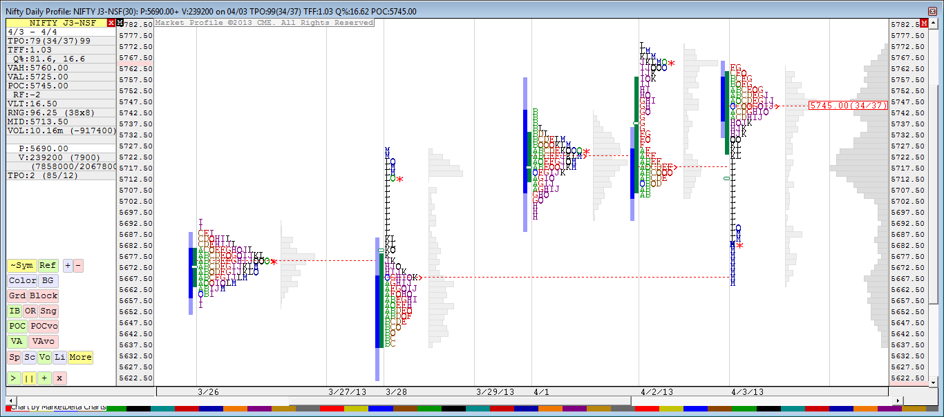

Is there a way to have daily TPO chart with a bigger time frame TPO on the same chart set to the right of the daily TPO's?
Also is there a way to do the same thing but with the bigger time frame being a volume profile?

What do you mean? Daily TPO and TPO on the right of the screen?Do you mean a volume profile to the right as this is what your chart shows?

It is not possible to have a TPO chart with one timeframe and then a single TPO on the side with a different timeframe.
This is possible with the Volume by Price profiles. To do this, you would have 2 Volume by Price studies. Follow the instructions here for the second study that is aligned to the right and has a different timeframe from the others:
Volume By Price Study: Single Volume Profiles At End of Chart
Also, what you show in your image is a TPO chart with Volume by Price for each TPO, along with 1 Volume by Price aligned to the right. This is also possible to do. Refer to the documentation here for having Volume by Price studies associated with the TPO profiles:
Time Price Opportunity (TPO) Profile Charts: Displaying Volume Profiles

Rassitude, what i was referring to was having daily tpo chart with a weekly/monthly/ or other time frame tpo located on the rt side of the same chart, therefore you can see where the current tpo (daily) is in reference to a longer timeframe TP (monthly)...ie short term vs long term value areas, poc's etc
[2019-06-26 03:36:17]
In addition to what is given in post #3 you also need to set this Input to Yes for the volume profile on the right side:
Volume By Price Study: Set as Independent Volume Profile for TPO Chart
