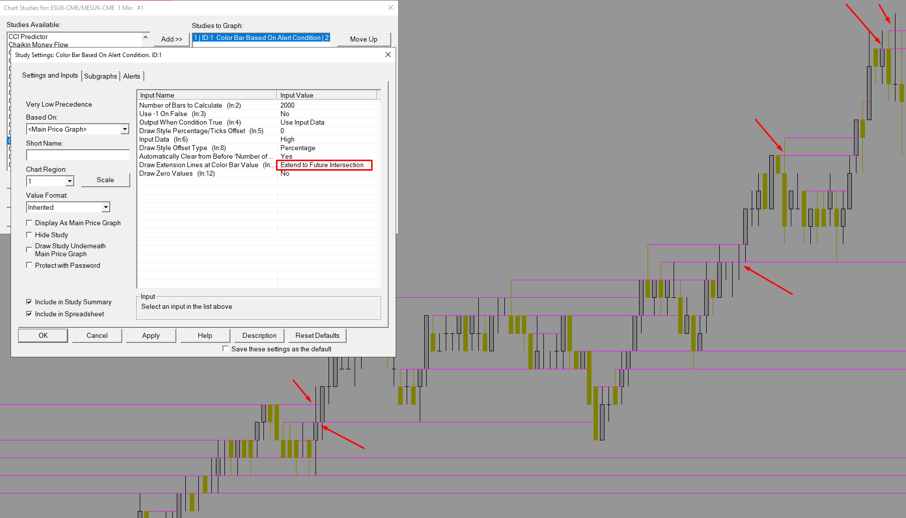

Sorry to say that. In "Color Bar Based On Alert Condition" the normal "Extend to Future Intersection" Function is now broken. It has the same behavior as the new "Extend to Future Bar Close Crossing" method.
Tested with Version 1948
A rollback helps more people I think.
Date Time Of Last Edit: 2019-07-13 12:22:45
imageColor_Bar_Based_On_Alert_Condition_Extend_to_Future_Intersec.png / V - Attached On 2019-07-13 12:13:06 UTC - Size: 85.7 KB - 587 views
[2019-07-15 06:34:50]
We apologize for that. This will be resolved in version 1949 which will be out in about 20 minutes.
