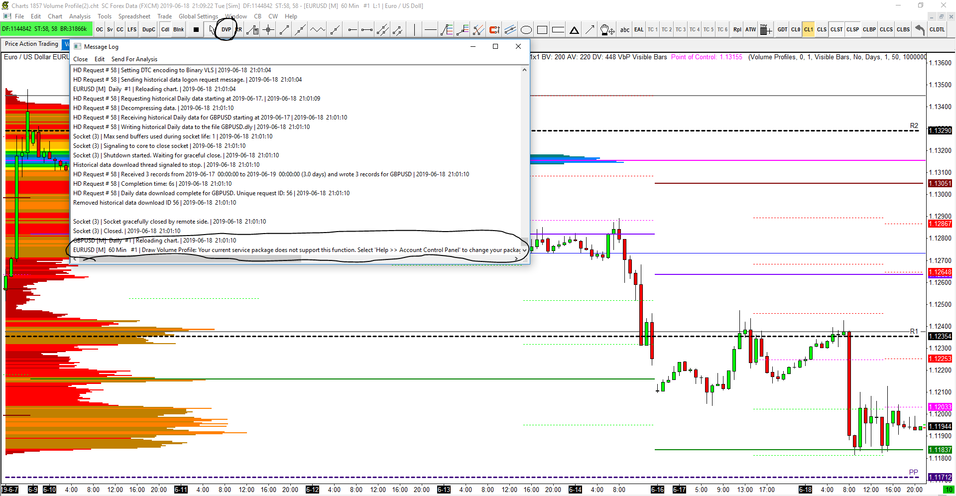

Hi There,
Whenever I try to use the DVP tool I get an error message (see attached)
However, I am still able to use the standard volume profile just fine.
Please advise. Thanks.
imageDVP not working.PNG / V - Attached On 2019-06-18 21:11:14 UTC - Size: 120.39 KB - 440 views

For this you need the Advanced service package. Follow the instructions below:
To change your Sierra Chart Service Package, select "Help >> Account Control Panel" on the Sierra Chart program menu. On the displayed webpage, click on the "Set Service Package for Renewal" link.
Or go to this page:
https://www.sierrachart.com/UserControlPanel.php?page=ServicesActivation
You will need to login if you are not currently logged in.
In the "Available Services >> Choose Usage Time Service Package" frame, select the Service Package that you want to set your account to. Press the "Set" button.
The remaining service usage time on your account will be adjusted based upon the cost of the package you are changing to. If the new package is a higher-priced package, then the usage time will be reduced due to the higher price.
There is no charge for changing your Sierra Chart service package. Only your Sierra Chart account usage time ending date is adjusted.
