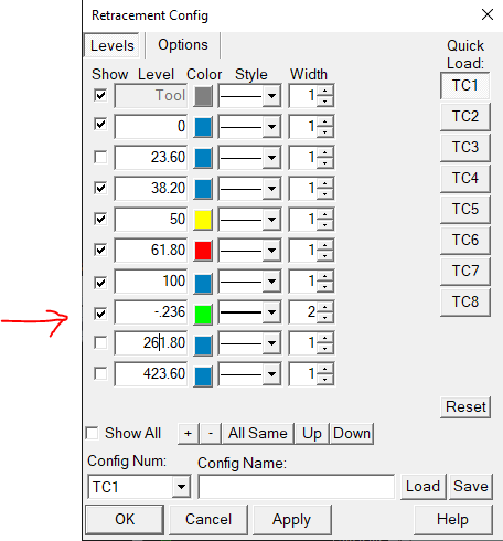

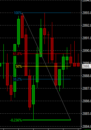

Please see attached screenshot.
imagefib-config.PNG / V - Attached On 2019-06-14 17:38:10 UTC - Size: 23.48 KB - 373 views
imagefib-picture.PNG / V - Attached On 2019-06-14 17:38:20 UTC - Size: 15.61 KB - 471 views

The 0% line is still there, but it is being covered by the -.236% line.
You have the -.236% line set to a Width of 2, which makes it cover up the 0% line. If you turn it off or make a width of 1, you should be able to see the 0% line, although it is going to be very close to the -.236% line.
As to the label, it is also being overridden by the -.236% label, and since they are larger, there is no way to get it to show at the same time.
