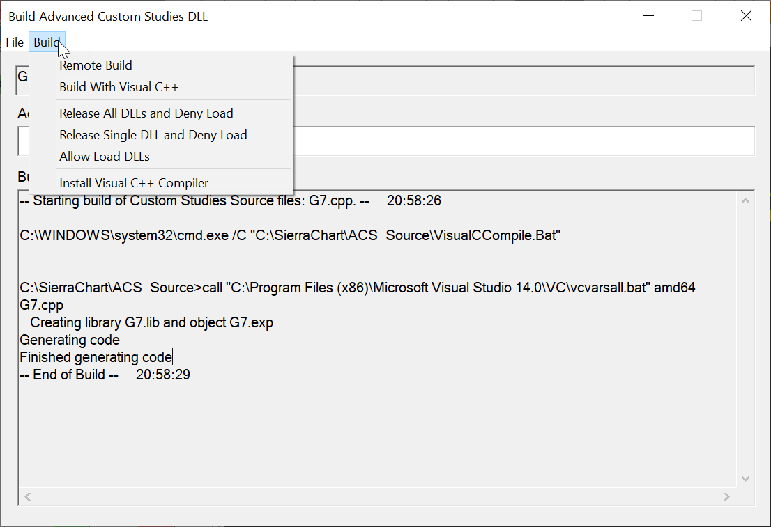

[2019-05-21 20:09:35]
grantx - Posts: 244
Same error message.
I have:
- Installed visual C++ compiler (Build >> Install Visual C++ Compiler.)
- Installed Visual Studio 2019
- Built the CPP file BUT there is not an option such as "Build with Visual C++ - Debug" = The Debug part isnt there see screenshot
WHen I select "Build with Visual C++" (No -Debug remember because I dont have that as an option) it seems to work because I get:
-- Starting build of Custom Studies Source files: G7.cpp. -- 20:58:26
C:\WINDOWS\system32\cmd.exe /C "C:\SierraChart\ACS_Source\VisualCCompile.Bat"
C:\SierraChart\ACS_Source>call "C:\Program Files (x86)\Microsoft Visual Studio 14.0\VC\vcvarsall.bat" amd64
G7.cpp
Creating library G7.lib and object G7.exp
Generating code
Finished generating code
-- End of Build -- 20:58:29
Then I:
- Open Visual Studio and load up the CPP file.
- Attach to SierraChart64 using native mode
- Put the breakpoint and get the same error message as before.
The breakpoint will not currently be hit. No symbols have been loaded for this document.
Because I could not build with the debug option I do not have that important .PDB file Im supposed to have.
What next Sierra? What else do I have to do?

[2019-05-22 00:47:29]
Update to the latest version of Sierra Chart and you will have the option for Build With Visual C++ - Debug.
The instructions to perform a Fast Update can be found here:
[2019-05-22 09:04:04]
grantx - Posts: 244
Well Ill be a multi coloured horn back toad. It works. Not without a significant level of frustration though. Mostly because of Microsoft and the order in which you have to install the software.
DO NOT install Visual Studio until you have installed vc_redist.x64.exe by executing this from sierra:
If you f*** this up and install VS first then you have to uninstall everything and manually uninstall C++ 2015 redistributable from the command line:
vc_redist.x64.exe /uninstall
Then re-install the Visual C++ Compiler. Only then can you think about Visual Studio.
Remember kids, none of this will work unless you have updated to the latest version of Sierra chart. Dont go rage monkey like I did....just do it in that order and save yourself a world of frustration.

[2021-07-28 19:06:39]
User403628 - Posts: 4
FYI - I installed the Visual Studio Community 2019 addition -
I was not able to successfully compile until I checked the following under installation details: MSVC v14.0 - VS 2015 C++ build tools
After that I can compile using the Build with Visual C++ - Debug option in Sierra Chart.
