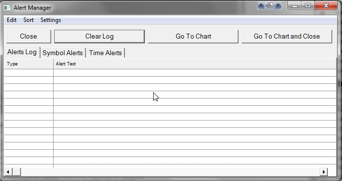

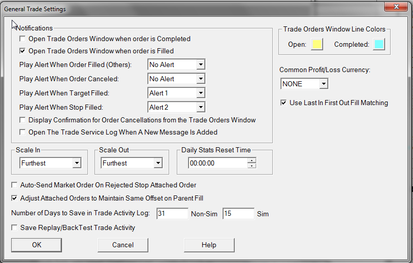

[2014-01-17 20:56:44]
vectorTrader - Posts: 86
That's the problem...there are no alerts shown.Please see attached settings.
