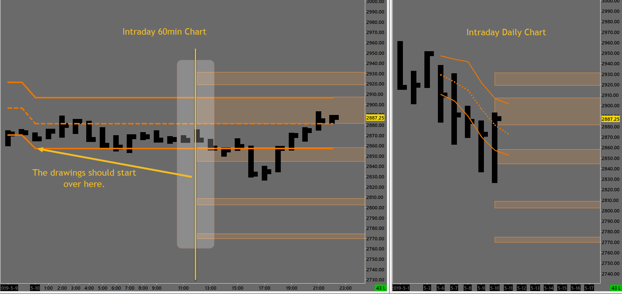

I use the extending rectangle drawing tool to emphasize daily support/resistance on intraday charts by using the "Copy Chart Drawing Feature" in the Advanced Chart Settings 2.
Problem is the copy doest line up with the start of the day. On the intraday chart, the drawing starts at 12:00am CET+1 and not 0:00am. I have this problem in a Sub Instance.
Using the same symbol and chart settings in the main instance, then the drawing gets displayed correctly. I attached a file for clarification.

imageChartdrawing's Copy.png / V - Attached On 2019-05-11 16:36:36 UTC - Size: 74.67 KB - 373 views

It is lining up properly and you have to look at the actual starting time of the bars in that daily chart built from Intraday data. There is no problem here. You need to adjust the Session Start Time in the Chart Settings in the source Intraday chart if you want to change this.
Date Time Of Last Edit: 2019-05-13 01:08:42

Alright, i found out what isnt working according to my understanding.
I actually have to MOVE!!! the drawing in the source chart. Reloading the destination chart or adjusting the drawing in the source chart wont update the drawing or draws it wrong.
