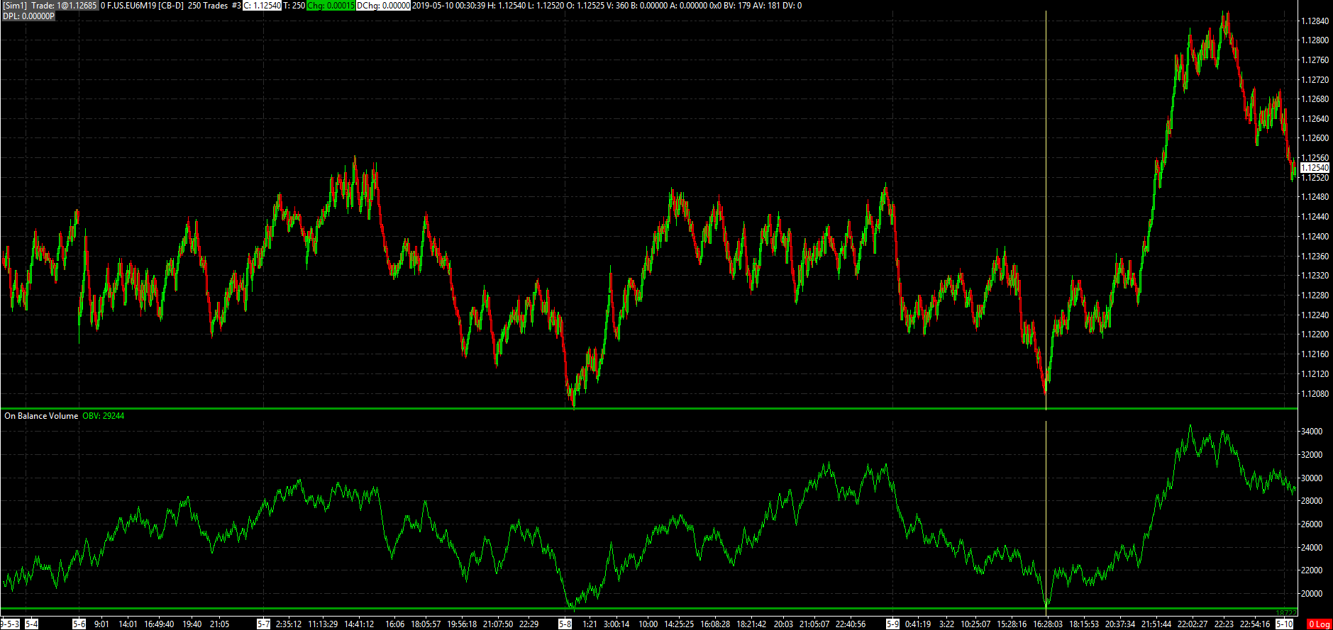

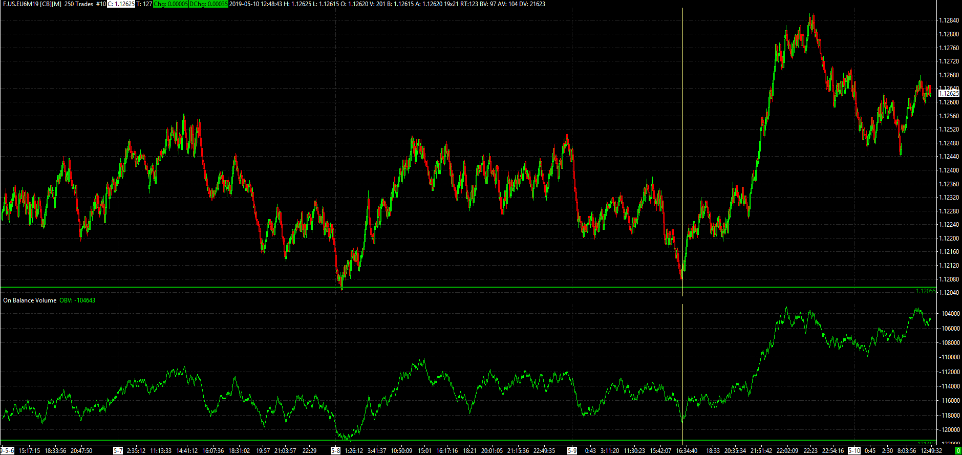

[2019-05-10 04:53:03]
FH87 - Posts: 43
Using 2 different Sierra chart, OBV study display differently .
Data CQG
settings i check are same.
Try delete data, still get different study
Need assistance on this problem.
http://www.sierrachart.com/image.php?Image=1557463773731.png
http://www.sierrachart.com/image.php?Image=1557463829472.png
Date Time Of Last Edit: 2019-05-10 04:55:04
[2019-05-13 14:55:02]
These are variable timeframe bars.
The first step is to make sure that the chart bars are the same. Refer to:
Number Of Trades, Volume or Range Bar Charts Do Not Match Setting or Are Not Accurate or Are Inconsistent
There is also a problem in one of the charts with building the continuous futures contract (The one with CB-D at the top). Follow the instructions here to update the Symbol Settings:
Global Symbol Settings: Update Symbol Settings
You may have to perform a Full Reset:
https://www.sierrachart.com/index.php?page=doc/GlobalSymbolSettings.php#FullResetSymbolSettingsSteps
After that reload the chart with Edit >> Reload and Recalculate.
