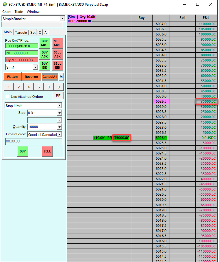

I have included a pic of my DOM with a simulated long of 10k XBTUSD on the BitMEX.
In the pic I'm 3.5 ticks higher than my entry price.
P&L though next to the entry price and in the P&L column says I'm "35000.0C."
What exactly does this mean and how am I supposed to interpret it?

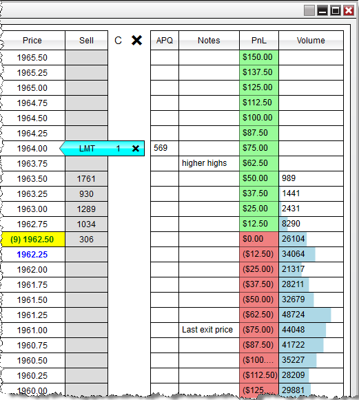

What I would like is for it be in USD.
$10.....$20.....$30. Etc. Like NinjaTrader's superdome (attached).

I read the documentation and as an experiment manually set the currency value per tick to 1.
The DOM P&L column is unchanged, it's still counting in increments of 5000 per tick (see attached).

I did....the result was the same. Each tick is still in increments of 5000.0C (whatever that means).
This is with a 10K sim position and a currency value of 1.

Since the quote currency is in USD, the 5000 C means 5000 USD.
This does make sense but you are using too large of a currency value per tick. That is not even remotely close to correct. Use the default:
Global Symbol Settings: Update/Apply Symbol Settings to Charts
Whether we have it right or not, we are not sure.
