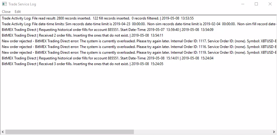

[2019-05-08 15:57:17]
User116783 - Posts: 84
Hey,
The same thing happened again today.
Order for 10K filled fine, then my profit target and stops disappeared.
I have attached a snippet of the trade service log.
Also I would like to add that I do have ample funds in my bitmex account.
ZS
Date Time Of Last Edit: 2019-05-08 17:09:27
imagetrade_service_log.png / V - Attached On 2019-05-08 17:09:22 UTC - Size: 231.26 KB - 409 views

[2019-05-08 17:41:44]
What is not clear to you in that log? The error is indicating the BitMex system is overloaded. That is a message from BitMex. Case closed.

[2019-05-08 18:00:48]
Why did I get filled then if the system was overloaded?
This has also happened back to back. Today and yesterday.
