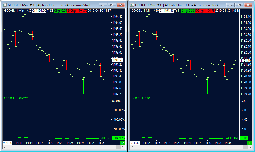

User796776 - Posts: 95
Since the 1881 release, charts using the Percent Change Since Previous Close study with a Value Format of 1% are now being multiplied by an additional 100 multiple.
Is there a way to display the scale as a percentage or do the charts need to be converted to use a Value Format of 0.01 to display the correct value albeit without the percentage sign?
image2019-04-30_14-37-41.png / V - Attached On 2019-04-30 18:42:08 UTC - Size: 30.91 KB - 547 views

[2019-04-30 20:35:41]
Multiplier is set to 1.
I only see the multiplier on the overlay not on the original chart.
Setting the multiplier to .01 makes the % correct on the overlay, but the original chart still has the issue.

[2019-04-30 21:22:51]
Let's concentrate on the original chart first. The Percent Change Since Open study has a Multiplier Input Setting. This is set to 100 by default. What is this set to and what is the Value Format set to?
[2019-05-01 02:08:31]
We have changed the default Multiplier Input setting to 1 for the Percent Change Since Open study which has the same issue. This solves the problem.
We will also add a Multiplier Input setting to the Percent Change Since Previous Close study.
