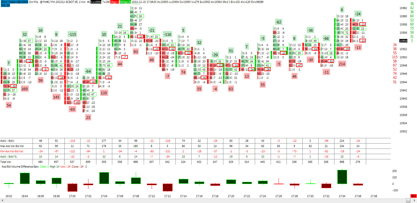

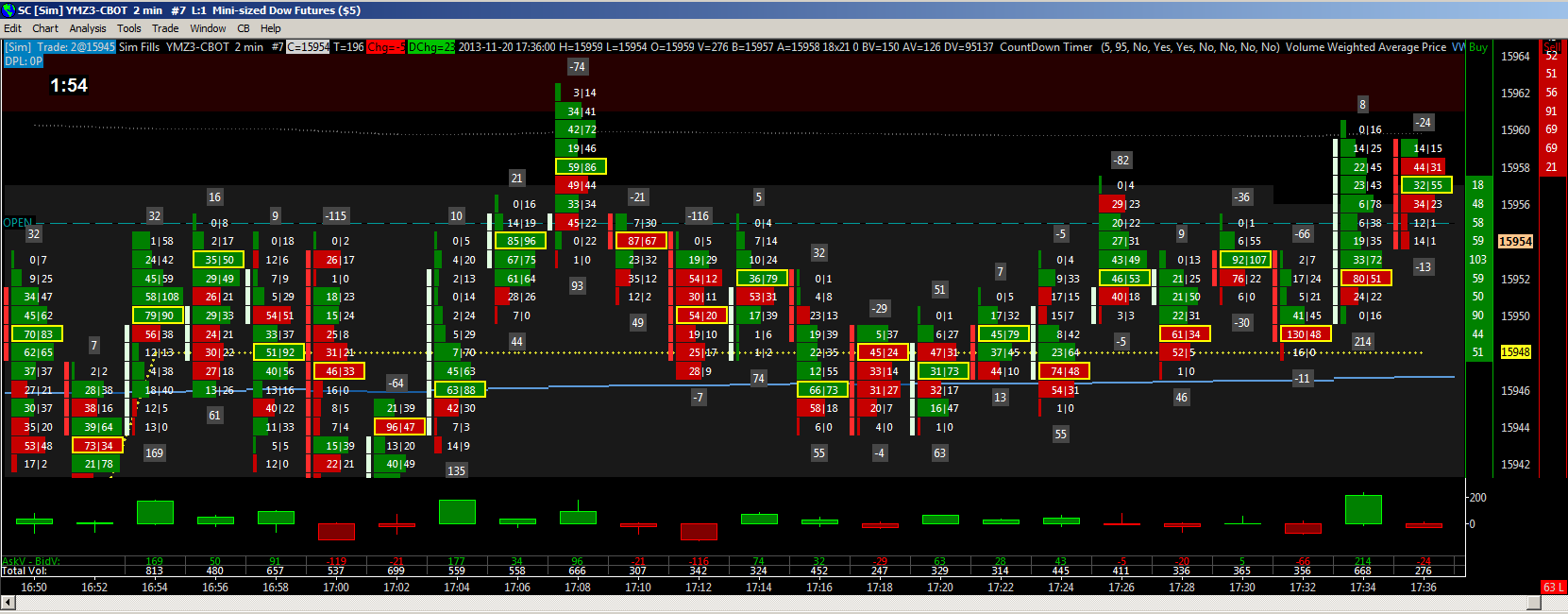

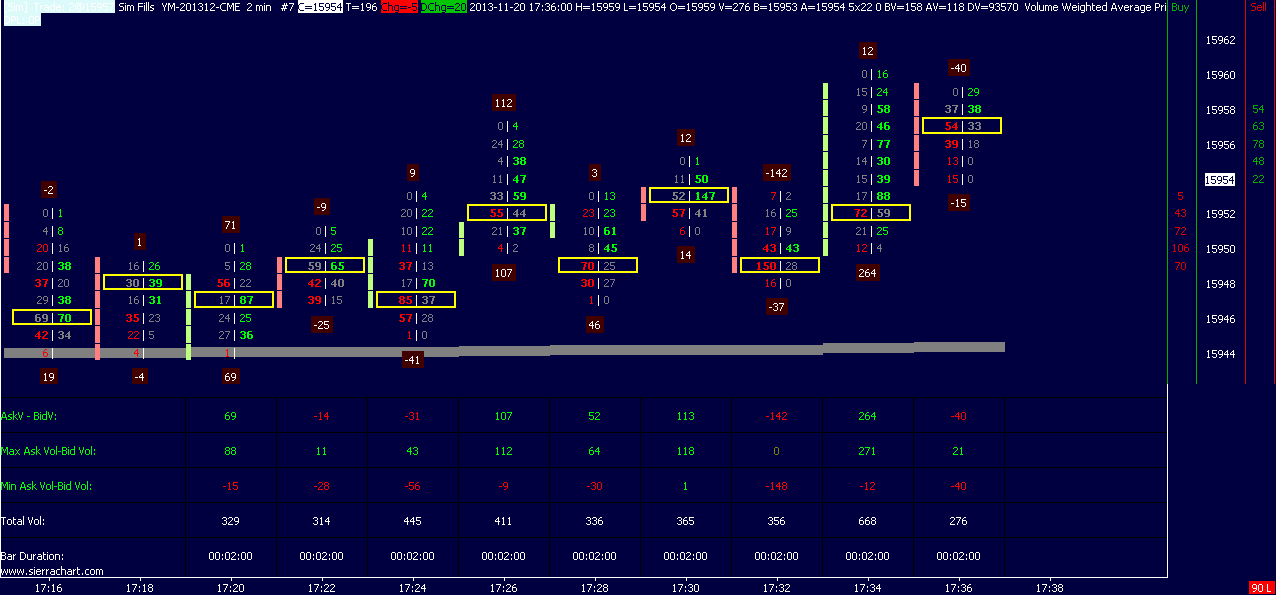

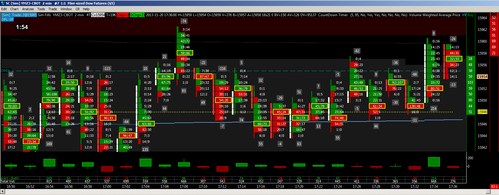

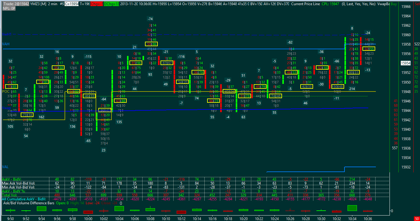

Hallo SC,
I have got the data and trading service with AMP/TTnet. I have compare bid/ask volume between IQfeed/ZenFire/SierraChart/and TTNet. IQfeed/ZenFire and SierraChart has the same bid/ask, but AMP/TTnet ist very different.
Can you tell me or help me why is TTNet different? Which data are correct? (according to this I suppose that TTNet isn´t)...?
Thank you a very much.
Date Time Of Last Edit: 2013-11-22 19:28:26
imageIQfeed.jpg / V - Attached On 2013-11-22 19:27:31 UTC - Size: 357.21 KB - 1141 views
imageData_SC.jpg / V - Attached On 2013-11-22 19:27:39 UTC - Size: 403.67 KB - 1130 views
imageTTNet.png / V - Attached On 2013-11-22 19:27:43 UTC - Size: 49.22 KB - 999 views
imageZenFire.png / V - Attached On 2013-11-22 19:27:48 UTC - Size: 89.49 KB - 853 views

TT FIX and TT Net do not provide accurate Bid Volume or Ask Volume.
