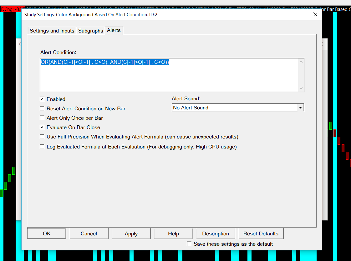

[2019-04-25 09:43:55]
Theseus - Posts: 6
Thank you for your help. But it didnt really work.
I need a alert for Green to Red brick reversal and vice versa. After closing
//Long entry if a bearish renko brick is followed by a bullish brick
//Short entry if a bullish brick is followed by a bearish brick
Please see my attached file which was the result with your code
Date Time Of Last Edit: 2019-04-25 12:06:03
imageRenko Candles.PNG / V - Attached On 2019-04-25 09:41:06 UTC - Size: 188.3 KB - 661 views
imagerenko setup.PNG / V - Attached On 2019-04-25 09:41:41 UTC - Size: 48.32 KB - 675 views
[2019-04-25 11:32:27]
Theseus - Posts: 6
with this code
For Green
=AND(ID0.SG23[-1]>ID0.SG22[-1], ID0.SG23[0]>ID0.SG22[0]
For Red
=AND(ID0.SG23[-1]<ID0.SG22[-1], ID0.SG23[0]<ID0.SG22[0]
Its colouring the second candle red or green and the following..
- But why is it not always colouring the second candle? Of course it is quite cool when its just colouring real reversals.
- And only the second candle?
Date Time Of Last Edit: 2019-04-25 11:44:42
imageRenko Candles.PNG / V - Attached On 2019-04-25 11:32:22 UTC - Size: 149.22 KB - 618 views
[2019-04-25 14:58:45]
Theseus - Posts: 6
it worked with this code
=AND(ID0.SG23[-1]>ID0.SG22[-1], ID0.SG23[0]<ID0.SG22[0])
and vice versa btw ;)
[2019-04-26 04:30:17]
Yes that is correct. We realize that we did not reference the open and close Renko values. But the true open and close instead. We have prepared the correct formula here:
Renko Bar Charts: Renko Reversal Bar Alert Formula
Date Time Of Last Edit: 2019-04-28 01:48:56
