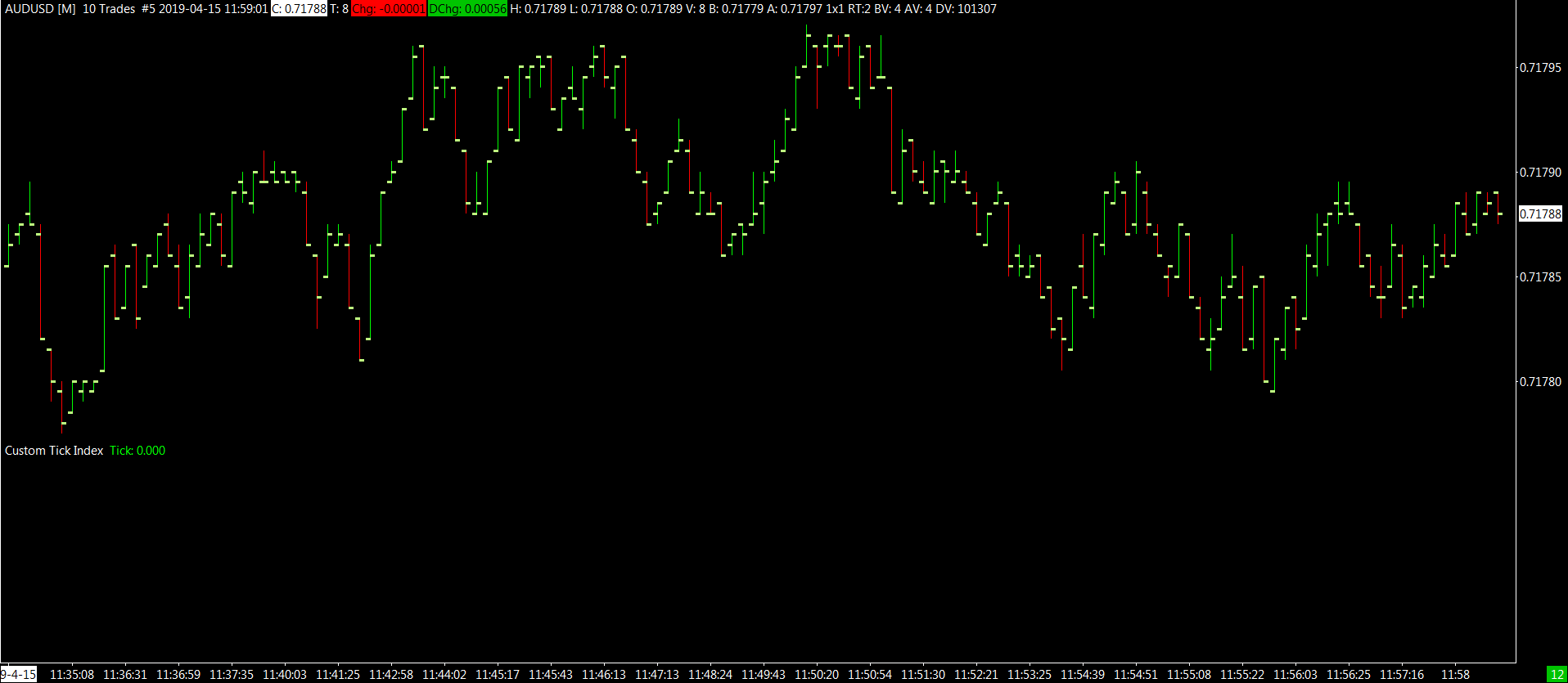

Hi SC,
The Custom Tick Index Study is not working. I used the official code which SC provides and created the Custom Tick Index Study. I only added SCDLLName("TickIndexStudyNW") to the code. Everything else just remained the same. The .cpp file named "TickIndexStudyNW" compiled ok.
I also followed the instructions in the study description. I have tried so many times and it still doesn't show anything on the chart. The study is below the chart but it just shows nothing. Please, see the .cpp file and the screen image.
What could be the issue? Can you run the code ok on your side?
Thank you for resolving the problem.
http://www.sierrachart.com/image.php?Image=1555347541501.png
