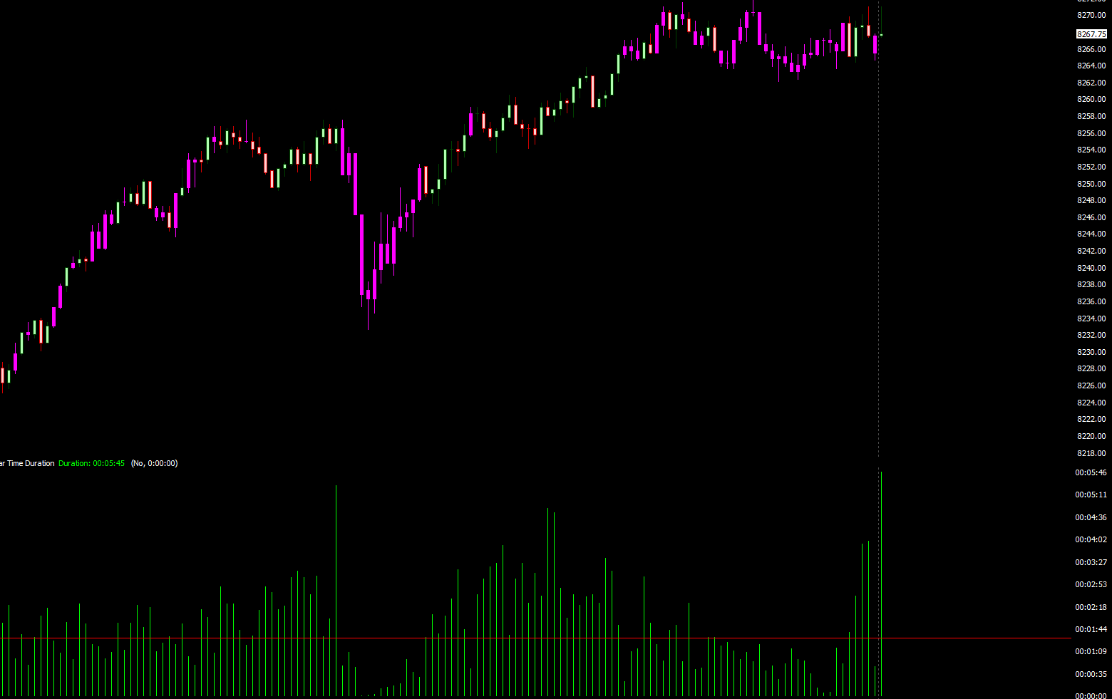

Ackin - Posts: 1866
I did realize bars are only colored for the current day
Try increase the number of bars
"Number of Bars to Calculate (In2):"
[2019-11-15 17:03:18]
Ackin - Posts: 1866
Unfortunately it didn't work. All bars are colored.
Try attached file
How to Use a Study Collection
How to Use an Advanced Custom Study or a Study Collection: How to Use a Study Collection
Date Time Of Last Edit: 2019-11-15 17:17:27
attachmentBarTimeDuration.StdyCollct - Attached On 2019-11-15 17:02:40 UTC - Size: 18.7 KB - 831 views
imageBarTimeDuration.png / V - Attached On 2019-11-15 17:02:49 UTC - Size: 27.41 KB - 756 views
