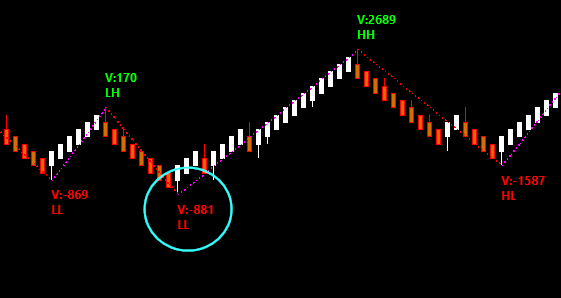

The delta accumulated volume for each zig zag rotation can be displayed as shown in the attached screenshot.
The subgraph SG5, accumulated volume, tracks the volume for "every" bar; however, I would like to know if the volume at "each rotation" (as shown in the attached screenshot) can be retrieved in order to be used in a alert.

hmm, that is my question... are there any "hidden" inputs? Because, obviously the data is there and it's being printed on the chart. So, how to access it for use in an alert?

First, you can use the SG2 subgraph in the Zig Zag to determine where the reversal is occurring. Refer to the following section of the documentation that explains how to use this:
Zig Zag: Zig Zag Reversal Alert
Second, there are a few "hidden" subgraphs that will be shown in the Subgraphs tab of the Zig Zag Study Settings when the option Additional Output for Spreadsheets is set to Yes. If you wanted to use one of these, then it would be SG3 Reversal Price. This gives the price at the point of the reversal. Therefore, if it is non-zero, that is where a reversal is occurring. Refer to the following for this Input and the related Subgraphs:
Zig Zag: Additional Output for Spreadsheets
