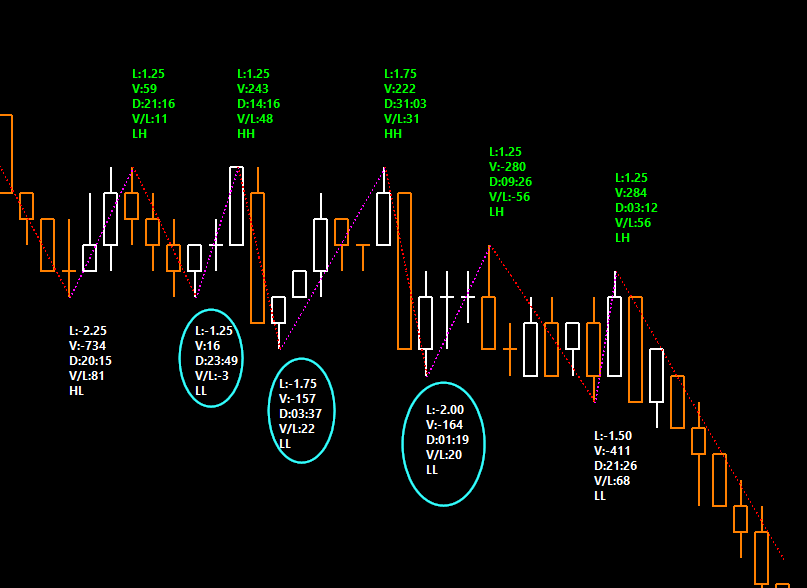

Thank for the response. A follow up question, and please refer to the attached image. Let's say I wanted to create an alert referencing the three circled zig zag lows. I can't seem to figure how to do that simply by using the zig zag value for the candle and oscillator. I can do it for a single candle, yes, but not for the group comprising the zig zag moves. Am I missing something? I would greatly appreciate any feedback. Thanks.

[2019-04-11 17:25:43]
John - SC Support - Posts: 47939
It sounds like your question is really how to get an alert across all the bars in the chart, and not just at the most recent bar. To do this, use the Color Bar Based on Alert Condition study. This study takes an alert and will test it across the number of bars specified in the study (default is 2000). By default, the study is set to color the bar a different color if it is true, but you can change that to something else if you like. Refer to the documentation for the study here:

[2019-04-12 17:06:41]
Sawtooth - Posts: 4354
Add the Spreadsheet System/Alert study, give it a name in the Spreadsheet Name field.
On the spreadsheet, enter these formulas:
Cell O3:
=IF(ID1.SG3@3>0,ID1.SG5@3,O4)
Cell P3:
=IF(ID1.SG3@3>0,O4,P4)
Cell Q3:
=IF(ID1.SG3@3>0,P4,Q4)
-where ID1 is the Zigzag study; edit as needed.
Row 3 is the current bar, so cell O3 will contain the most recent ZZ accumulate volume.
Cell P3 will contain the second most recent ZZ accumulate volume.
Cell Q3 will contain the third most recent ZZ accumulate volume.
You can use additional Formula Columns to continue this daisy chain reference for additional previous values.
Now, use formulas in K3 to N3 for your alert conditions, referencing cells O3, P3, Q3.
If you only want the Lows, you could use every other column's value.
Or you could use a more detailed formula referencing SG2 for only the LL and/or HL:
LH = 1
HH = 2
HL = 3
LL = 4
